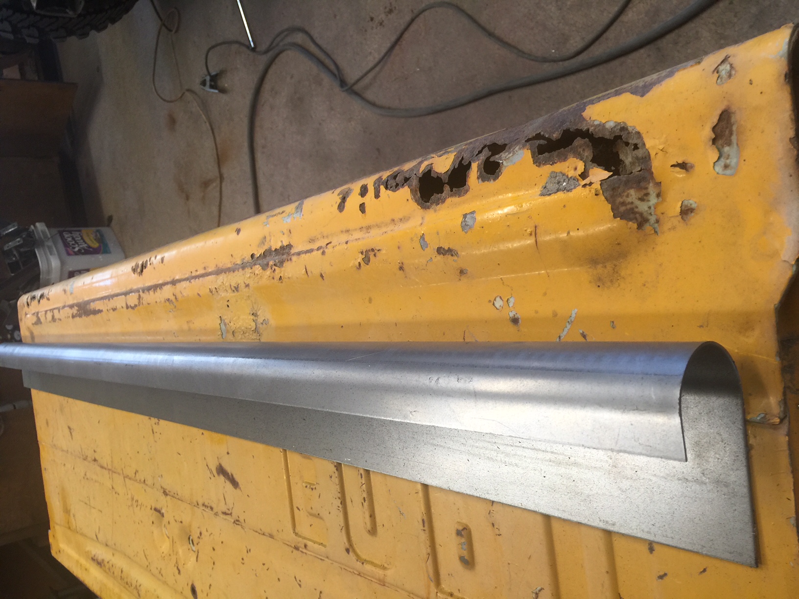

So I have to put that thingy in that thingy ,, rust removal
Postby Bill » Fri Nov 25, 2016 2:01 pm
Tedious work. Tail gates for broncos are about 425 , very expensive . the piece here is made for rust removal and it cost 35 smackers . Just more work for a guy who had shoulder surgery a couple months ago .

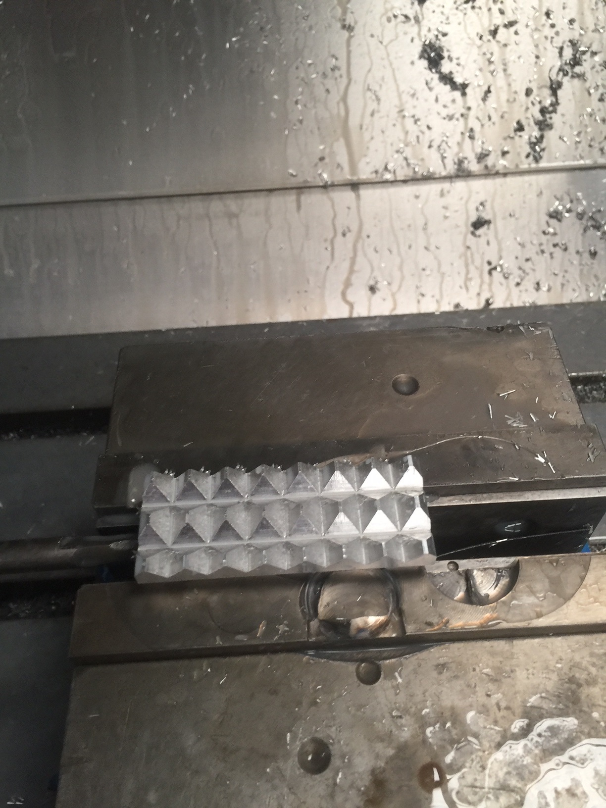

Postby Bill » Fri Nov 25, 2016 2:08 pm
So I had this image in my head of what my step would look like , I wanted this thing to look a little better than the others I had done , so I took one over to Robert Youngs buddy , Bruno at the CNC shop . Told him what I wanted and he did it while I waited . $40 for both of them

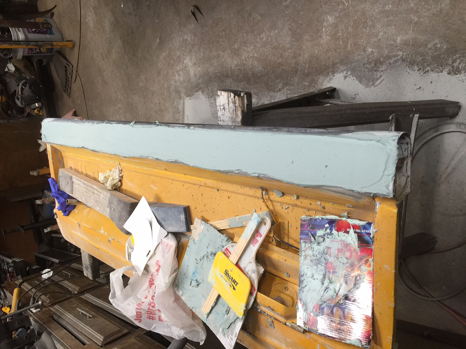

Back to the tail gate , welded it up and then put bondo on it twice then sanded it down , twice.
Postby Bill » Thu Dec 29, 2016 11:06 am
Body filler
Postby Bill » Thu Dec 29, 2016 11:11 am
I still was not happy with the tail gate there were simply too many little dings I had to mess with so I sold it on ebay for 300 and bought a new one from Wildhorses4x4. I was thinking the new tailgate would be ready to paint,,, wrong . There were annoying rivets sticking up that had to be taken down then body filler put in , then again ,, sanded, I only wanted the body filler over the rivets so I taped off the other area.
