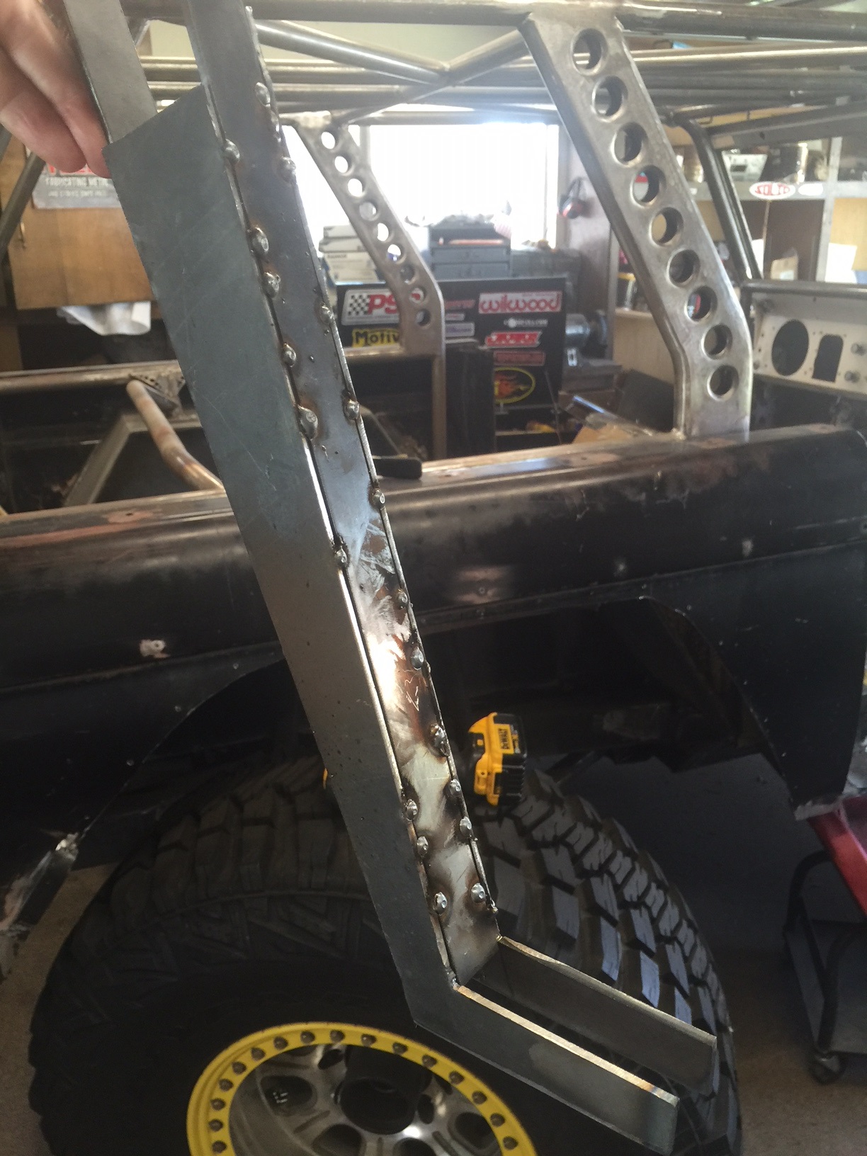

Postby Bill » Wed Sep 07, 2016 3:50 pm
So I plasma cut the pieces out of 1/8th to form up the step , then tacked the together

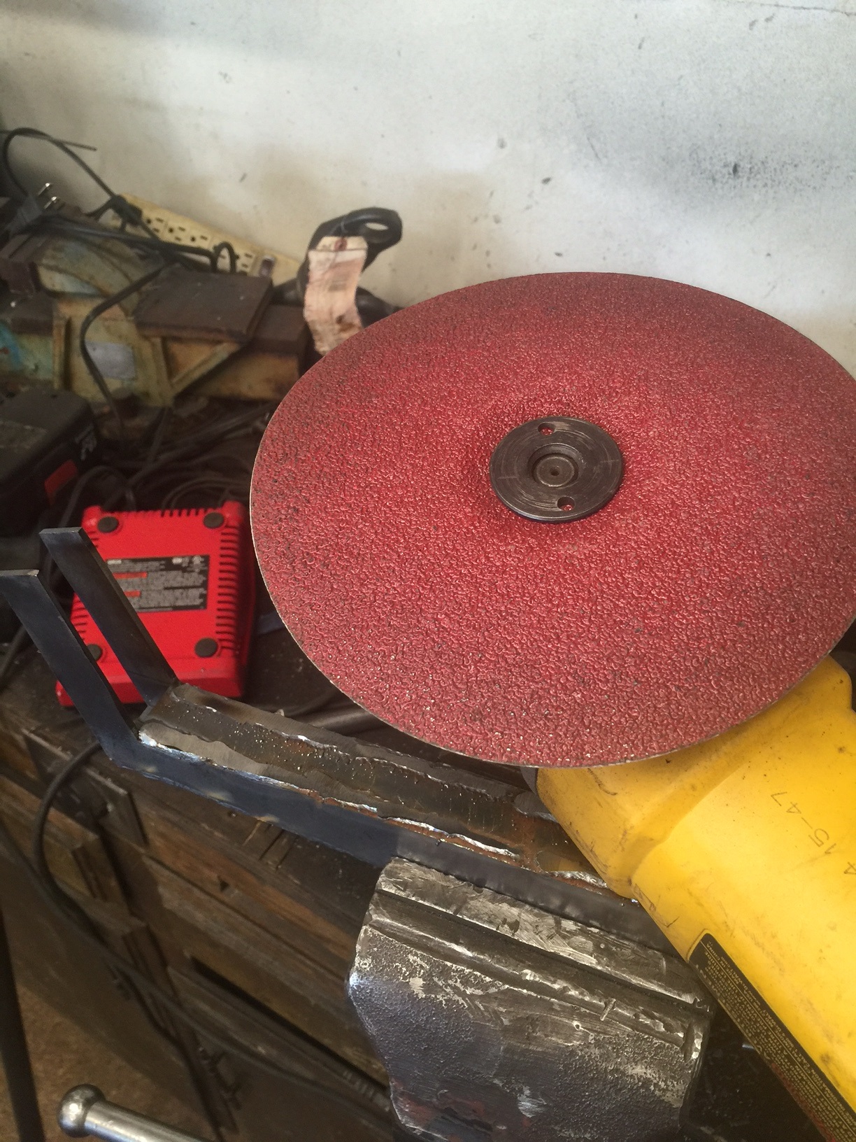

Postby Bill » Wed Sep 07, 2016 3:58 pm
The sander used to get it flat.

Postby Bill » Wed Sep 21, 2016 10:20 am
Ha Ha. This step was easier/faster. Having experience doing the blue bomber and big red it was easy. Now to weld the sliders to the frame. Upside down work , yuk
