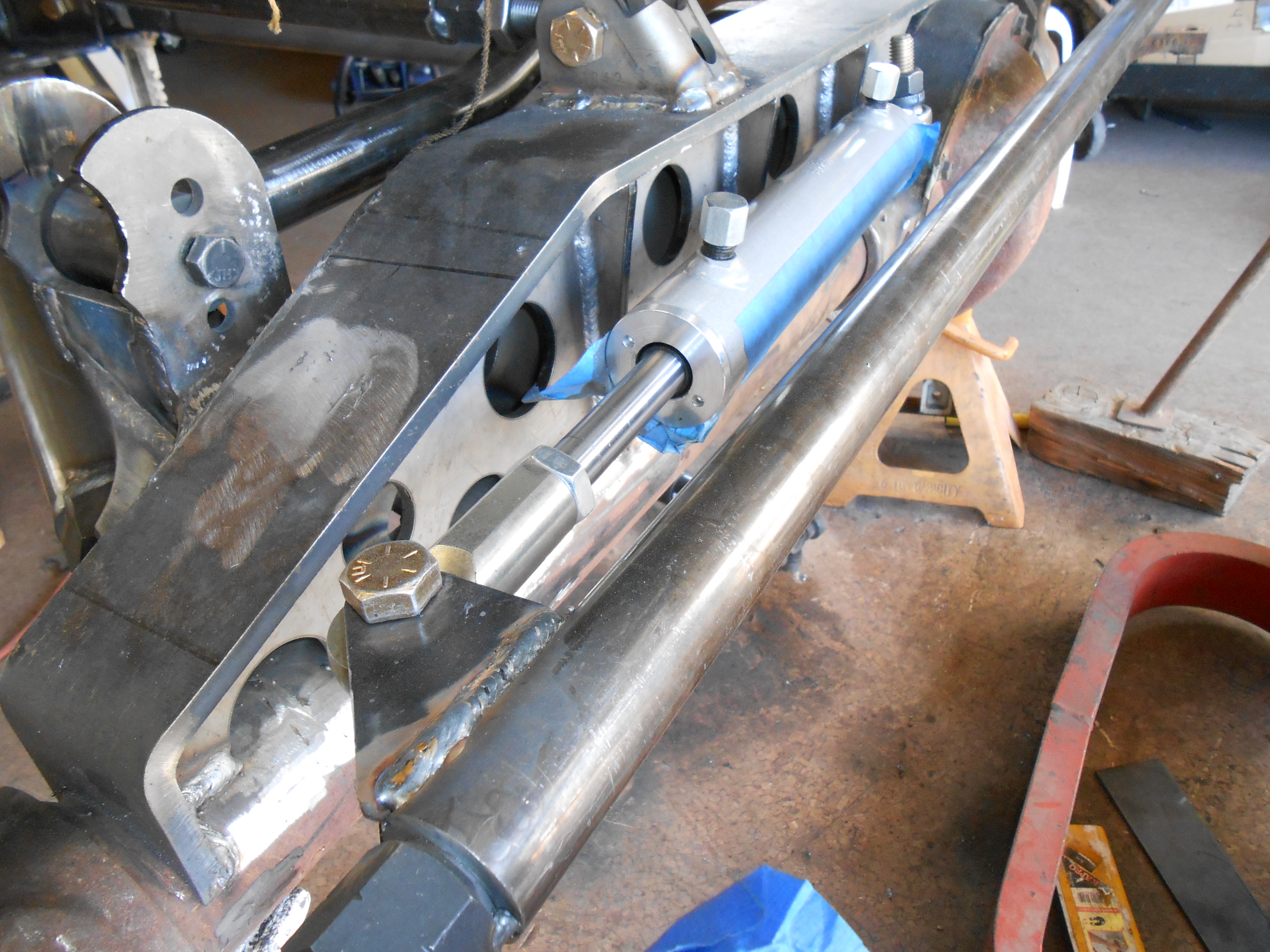

Mounted the hydro assist , it went on pretty easy

Double ended ram , with 1/4 wall 1.5 DOM tubing , Had to barrow Waynes bender for this stuff. Just a few more brackets and I'll be putting it back in ,, probably today Thursday
