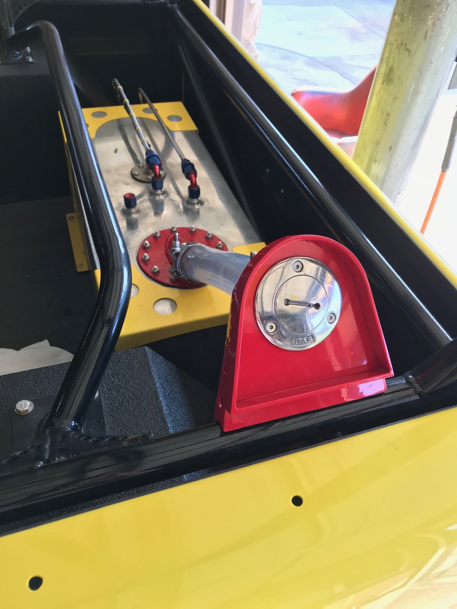

So I didn't like dragging a gas hose inside the bronco . So I cut off the neck at the tank filler neck welded a piece of 2 inch pipe at a slant inline with where I wanted to mount the new filler cap . Then made a bracket to bolt to the role cage I drilled and tapped 2, 5/16 holes in the bar. I had 2 chrome bolts left over from a bolt kit I bought which was supposed to be for a ford intake manifold , (bolt kits seem to never have the right bolts) . They were laser cut with a ford logo on them so that was pretty neat. Got a piece of clear hose from H&S hose . That hose is not rated for gas. I will have to see if it lasts very long. I had an old stainless boat style gas cap I'd saved for years . I polished it a bit and used it.
