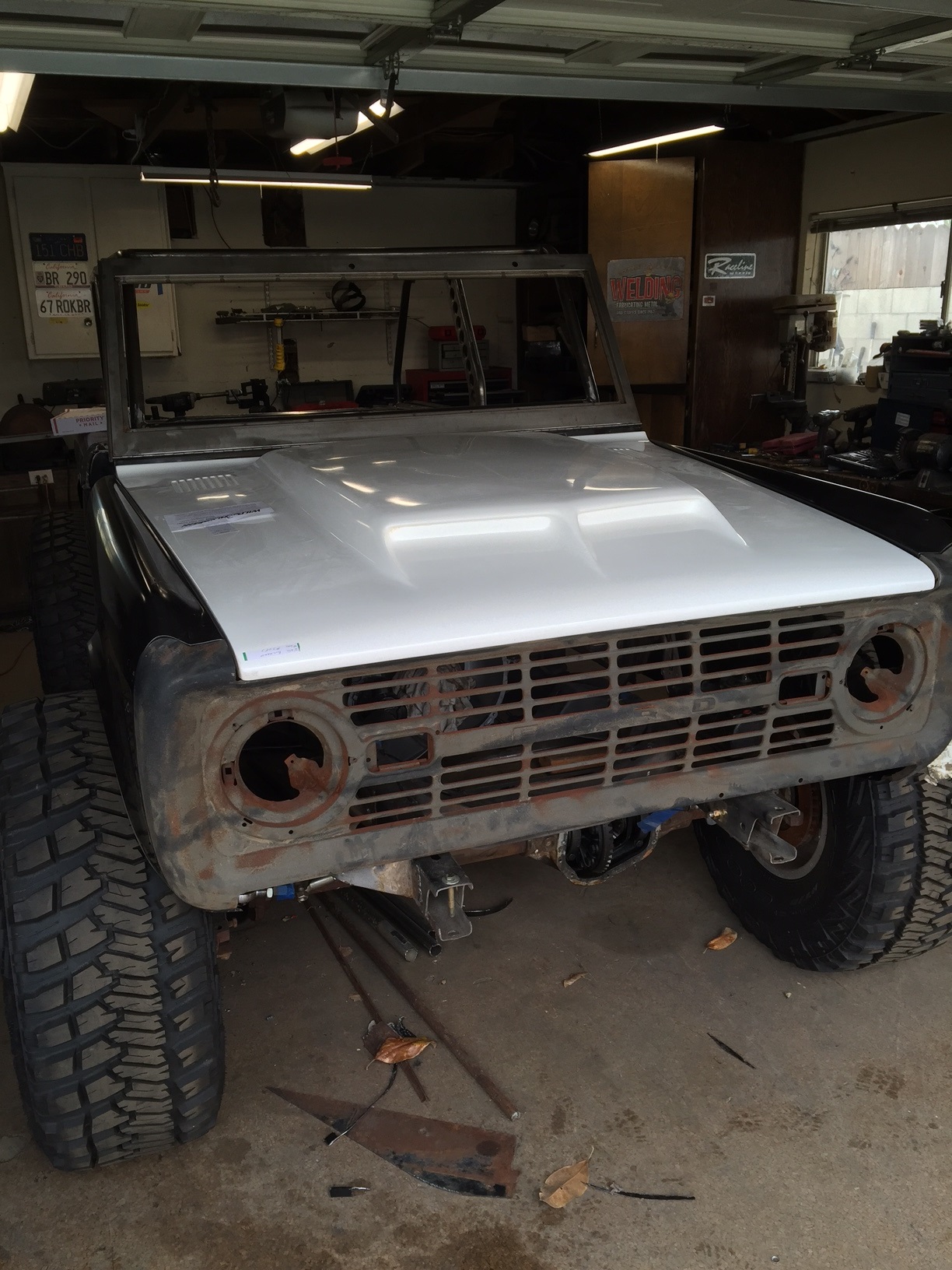

Postby Bill » Sat Apr 11, 2015 7:11 am

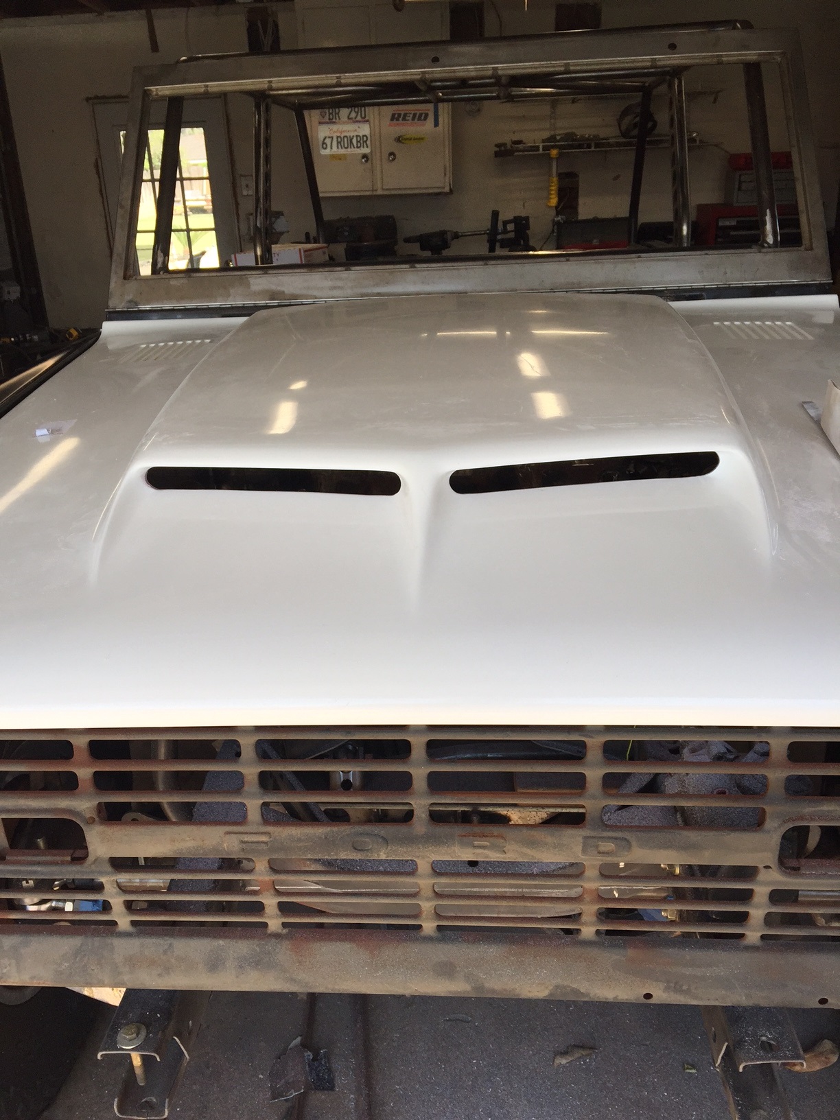

Had to cut holes in the buckaroo hood from wild horses,, I went slow,,,

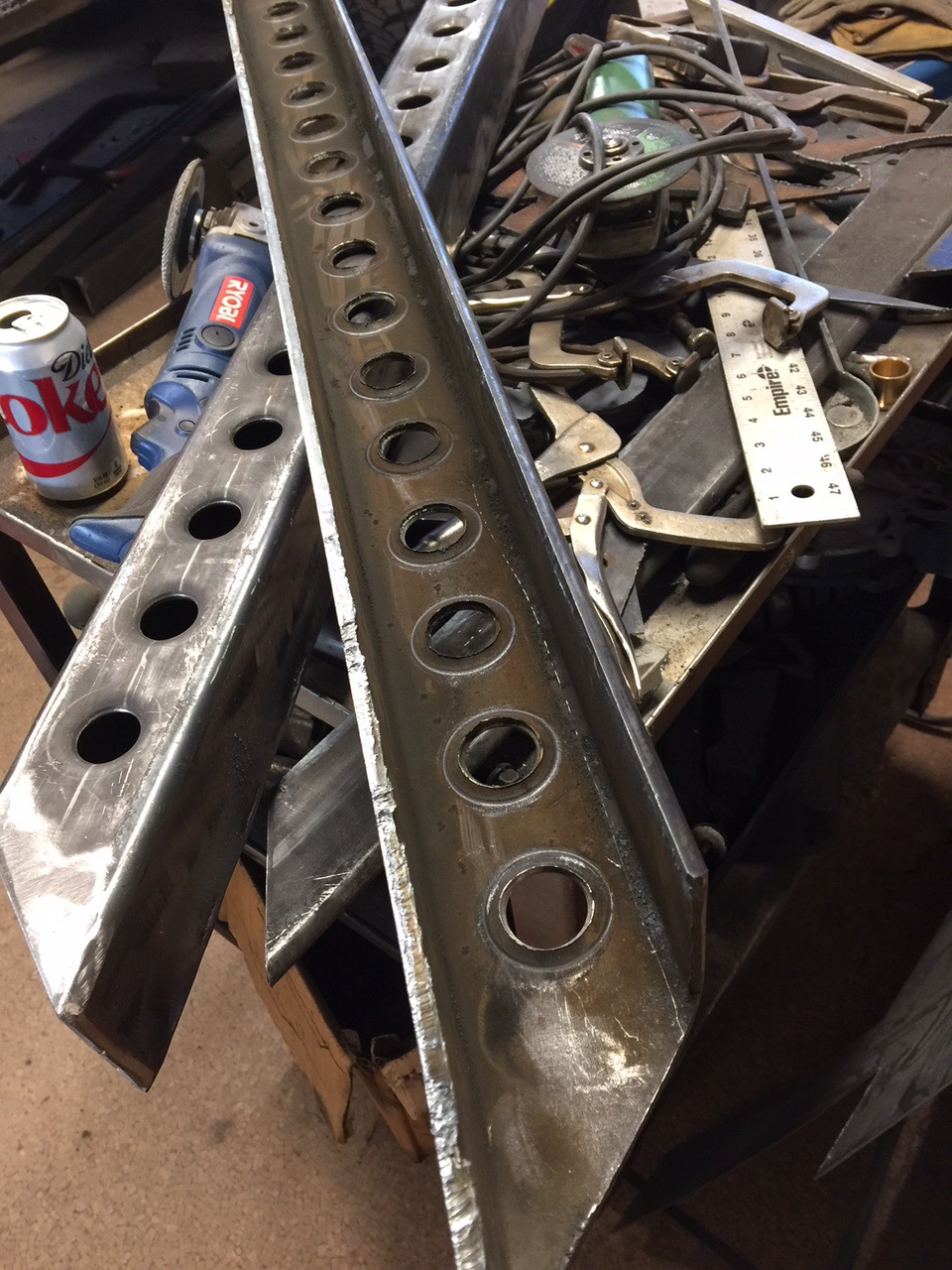

Postby Bill » Tue Apr 21, 2015 9:21 am

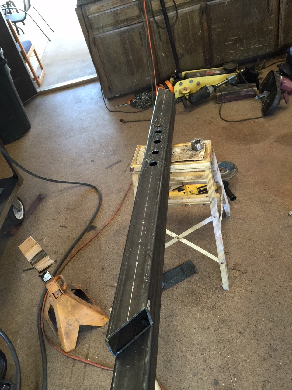

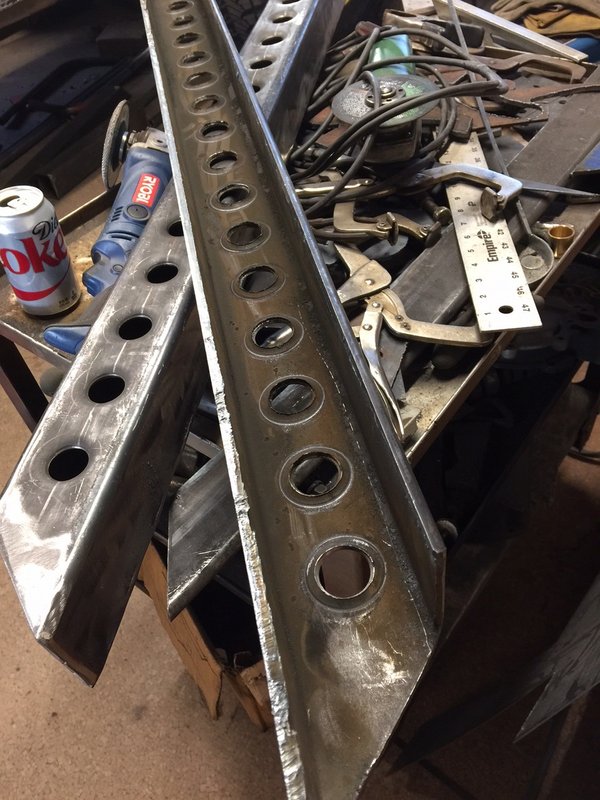

I made rockliders out of .188 3x3 square tubing,, I put 1 inch holes in them , bought a dimple die , 2 actually , I bought one by mistake so it was cheaper to sell it to Robert than to send it back. 15 samckers , good deal

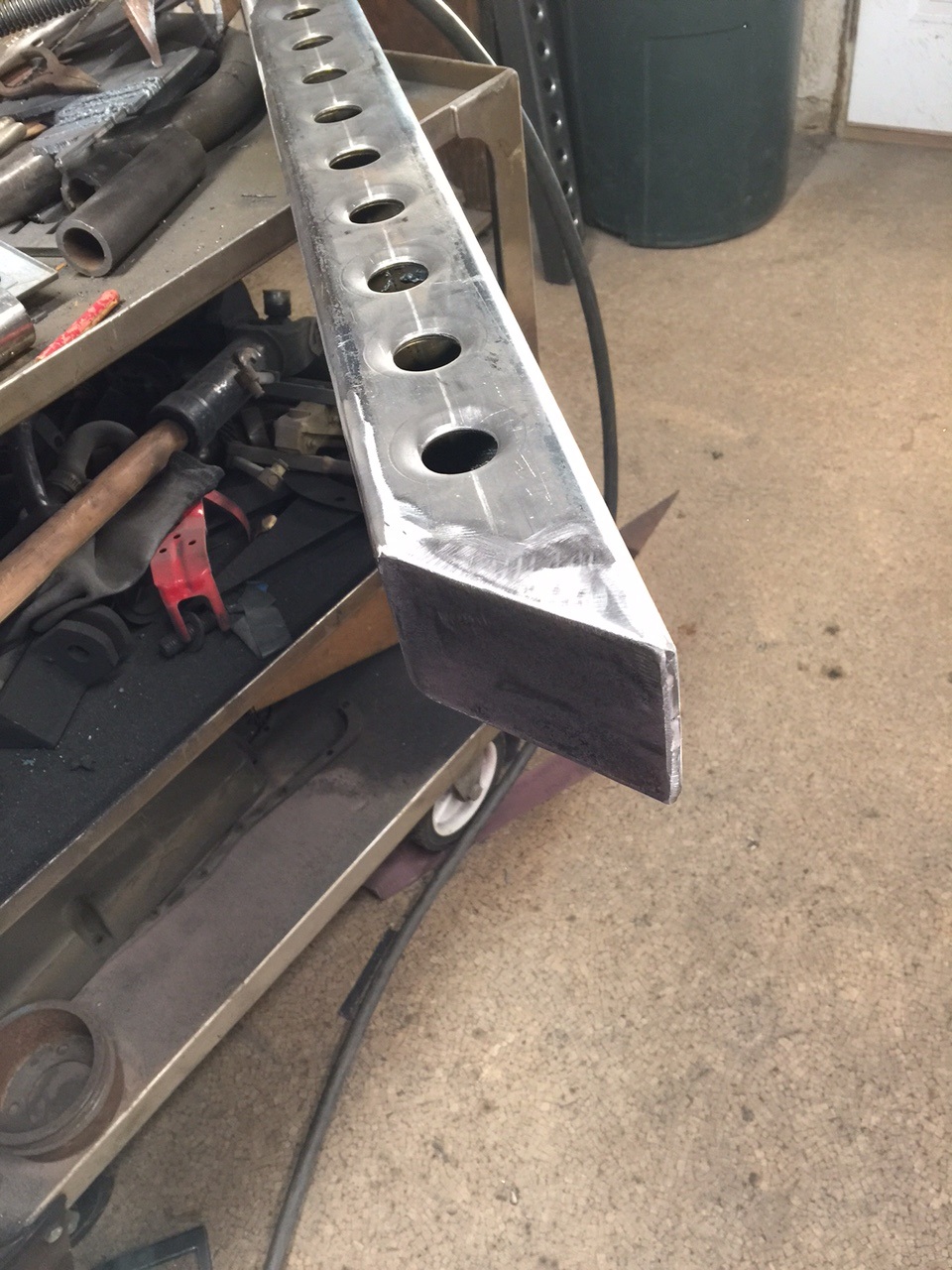

Postby Bill » Tue Apr 21, 2015 9:26 am

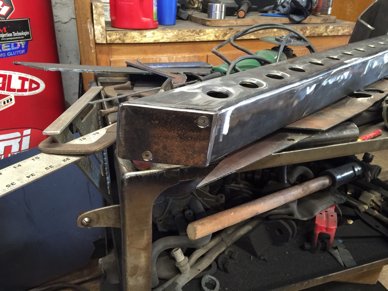

I wanted to put some LED strip lights in the rocksliders so indirect light could be seen inside of them , through the holes. So I capped the other end with some stainless screws

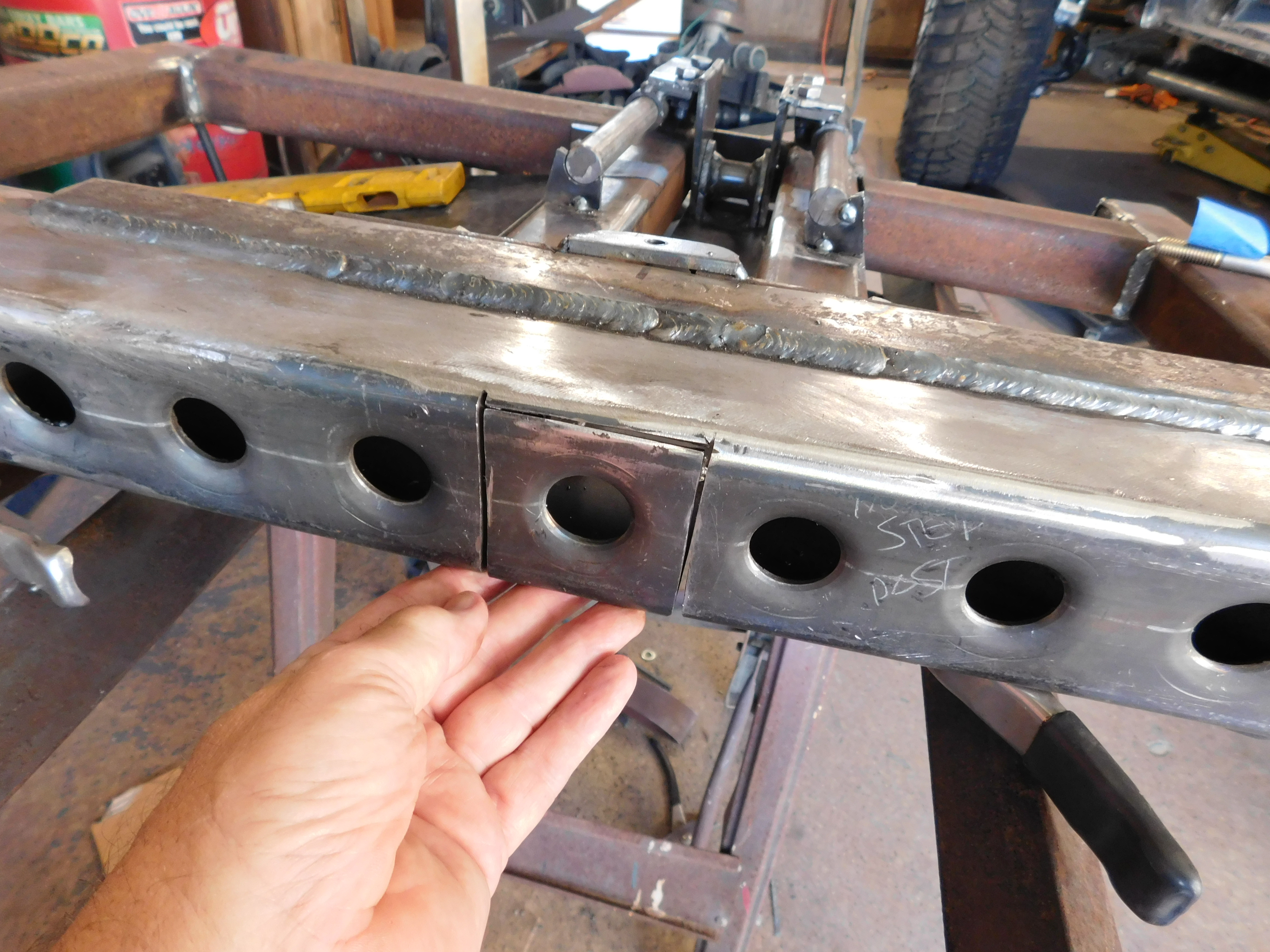

Postby Bill » Tue Apr 21, 2015 9:31 am
This was a little time consuming because I had to cut the back off of the 3x3 to be able to use the dimple die , then weld it back..

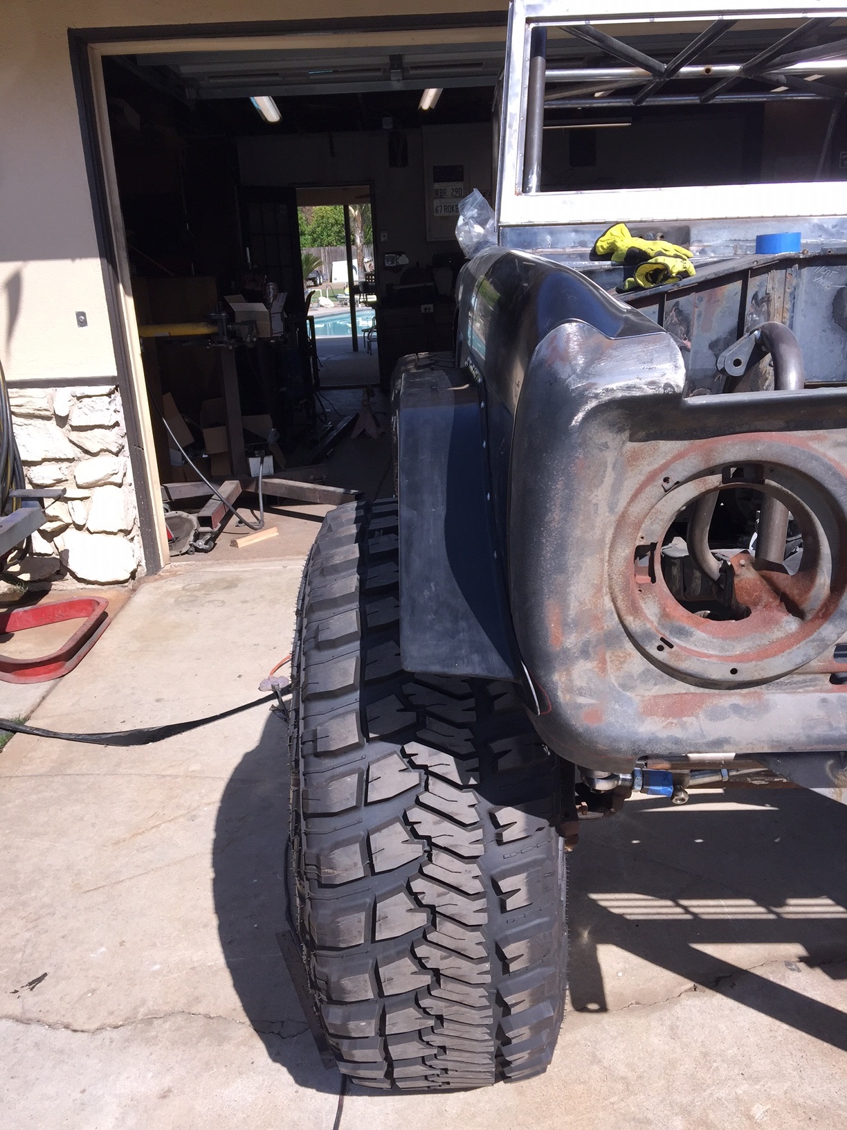

This crap takes time,, I have a sigfnificant gap between the door and window frame , so I found the measurements so I could see all the places that were screwed up

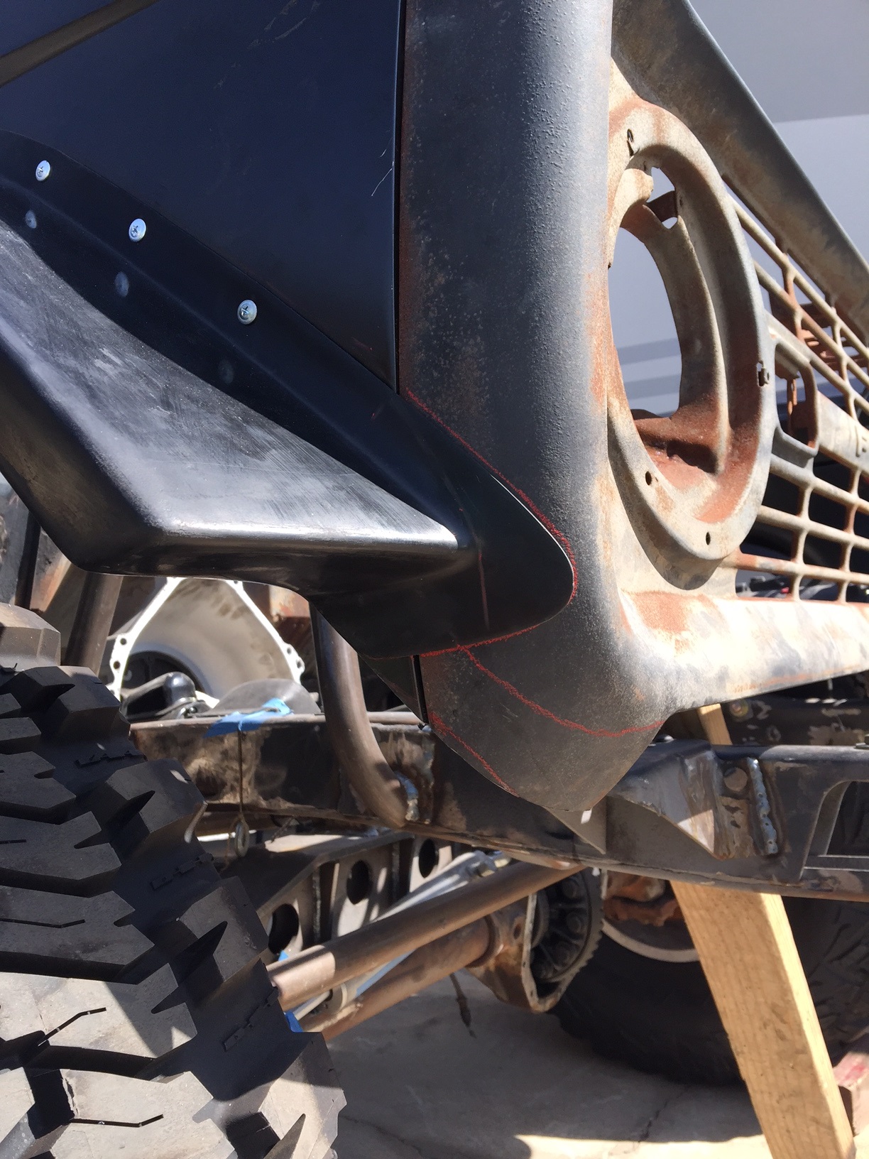

Postby Bill » Wed Apr 22, 2015 8:05 am

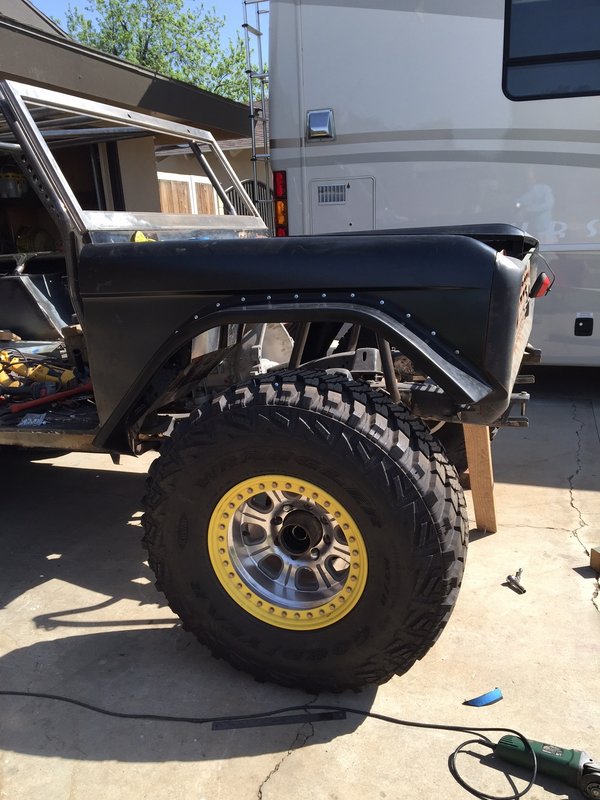

More flare pics ,, this is time consuming but its worth it

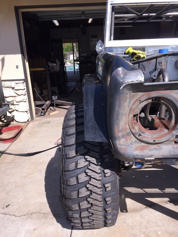

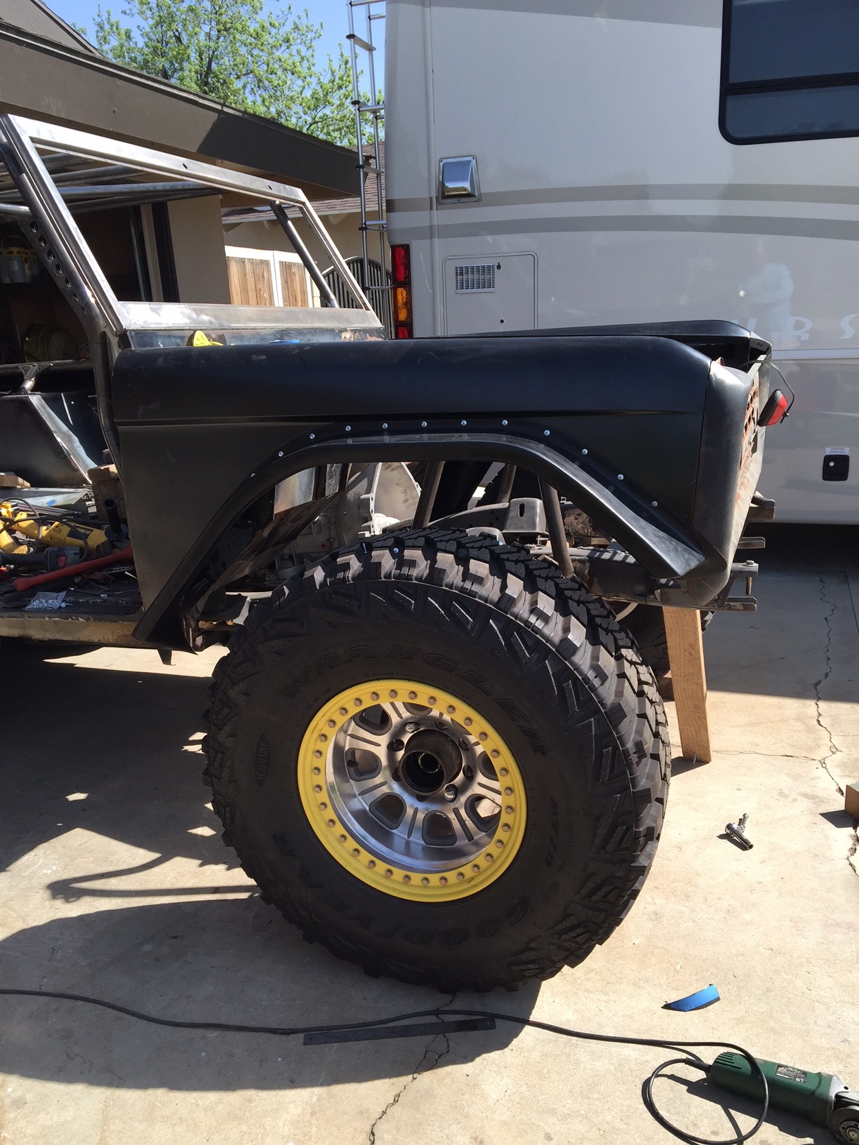

Postby Bill » Wed Apr 22, 2015 8:07 am
Flare and 14.5 tire , full width Dana 60

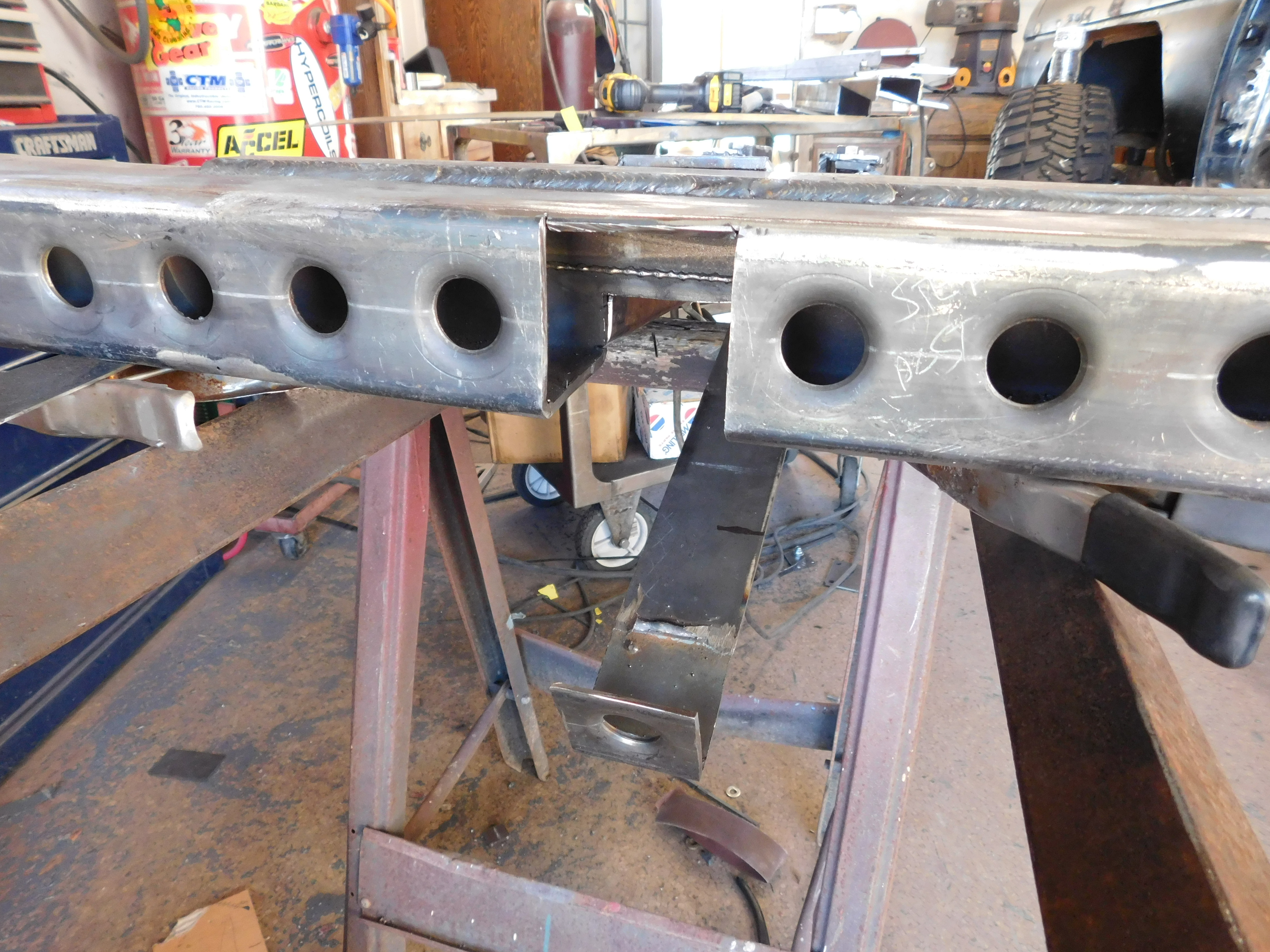

Postby Bill » Sat Aug 29, 2015 11:29 am
I'm trying to put a step on an actuator inside the rockslider
