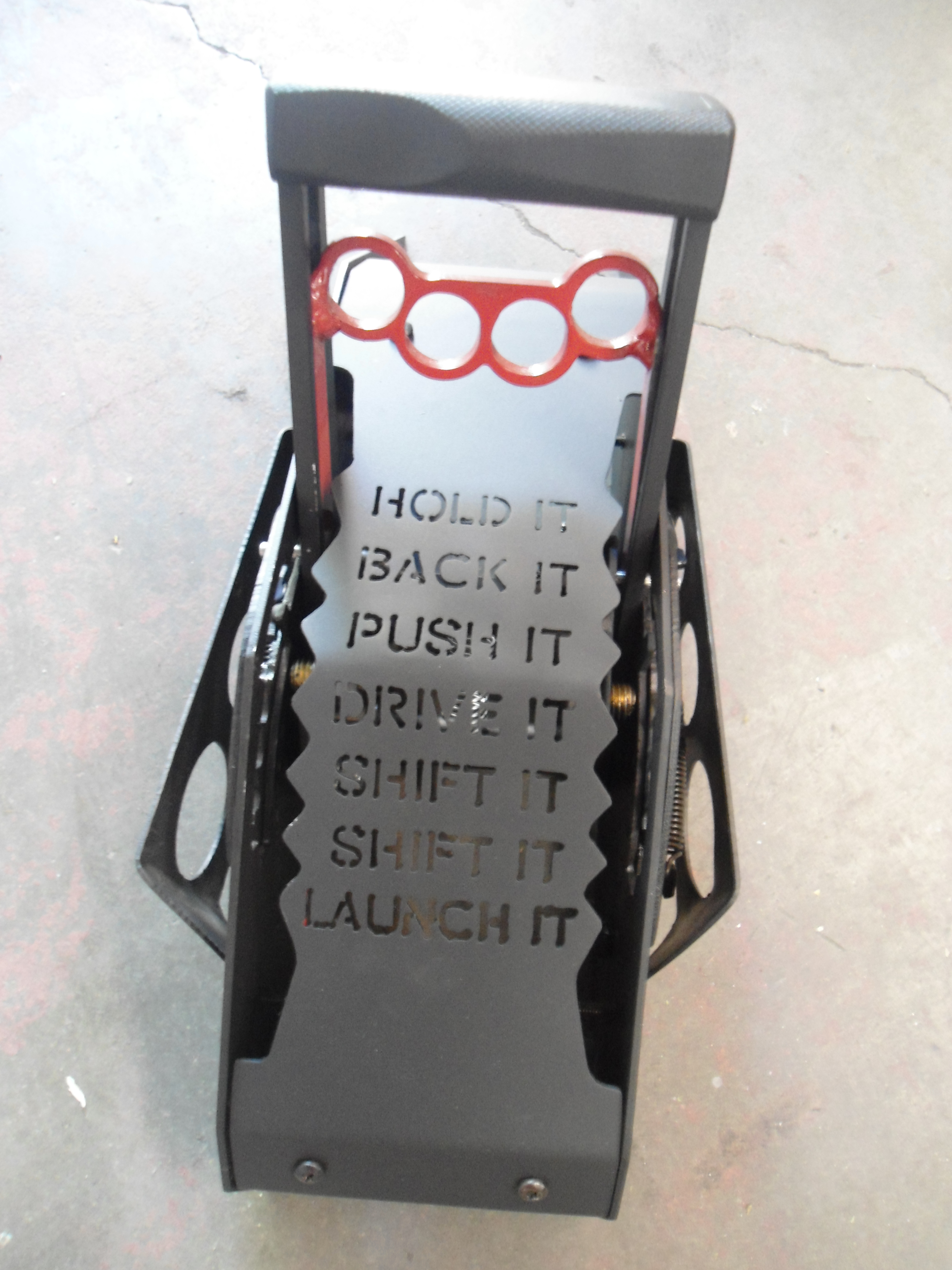

Postby Bill » Tue Mar 17, 2015 8:32 am

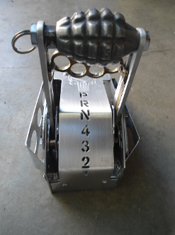

I like the lettering he can CNC for the shift positions this is an example, not my shifter, cool huh ??
Postby Bill » Tue Mar 17, 2015 8:38 am
So I like the red brass knuckles and the lettering ,,, I got, CRAWL IT, SHIFT IT, DRIVE IT, PUSH IT, BACK IT, HOLD IT., Nope no grenade for me ,, too militant. I had him leave the center and those little side protectors metal finish and I plan on powder coating them yellow. The rest come powder coated gloss black.

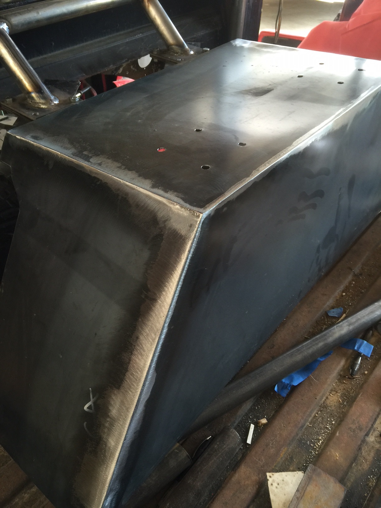

Postby Bill » Wed Mar 18, 2015 4:19 pm

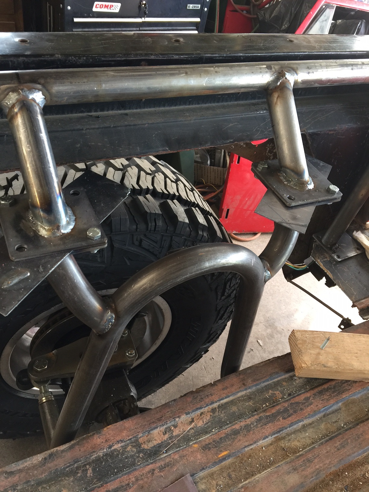

So,,, needed to weld up those shock hoop supports , metal does strange things when heated so I put some 16 gage between those brackets , the fender wells are 16 gage , then bolted them so everything stays in alignment

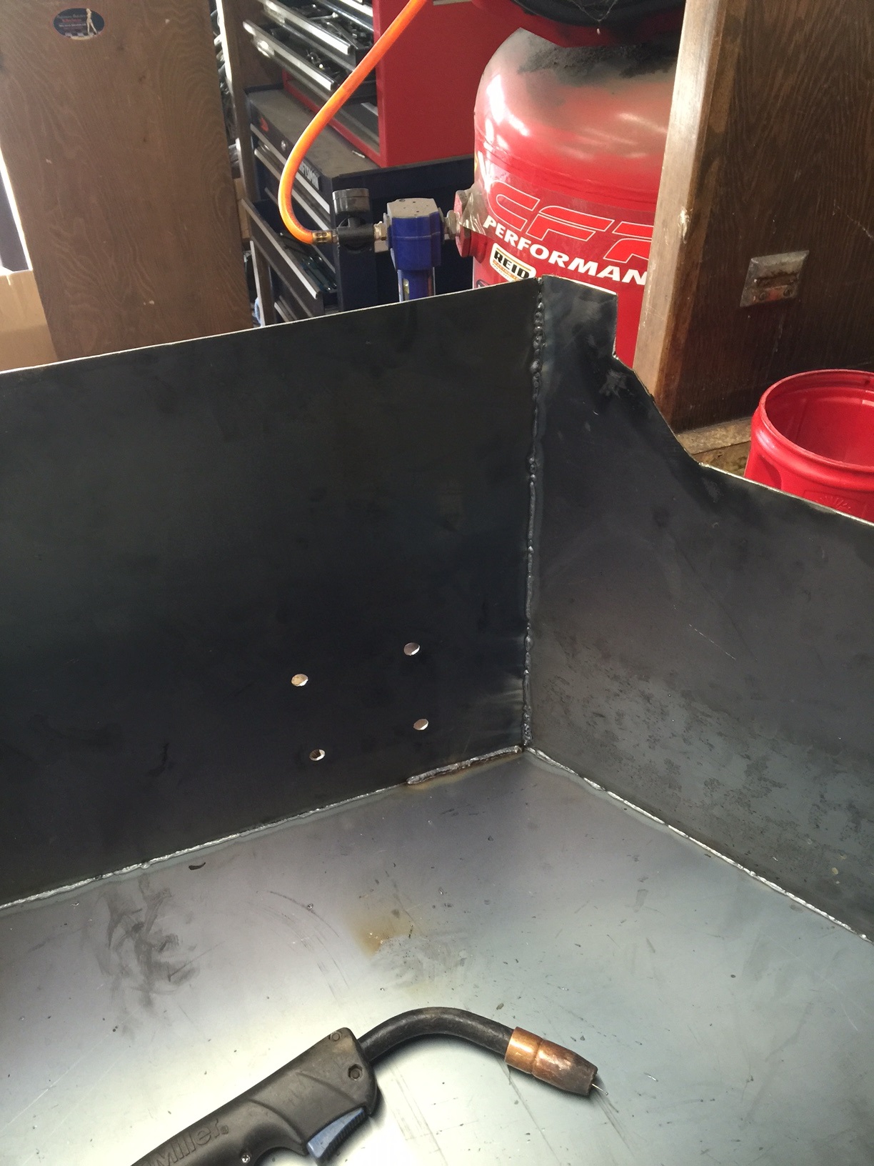

Postby Bill » Wed Mar 18, 2015 4:21 pm

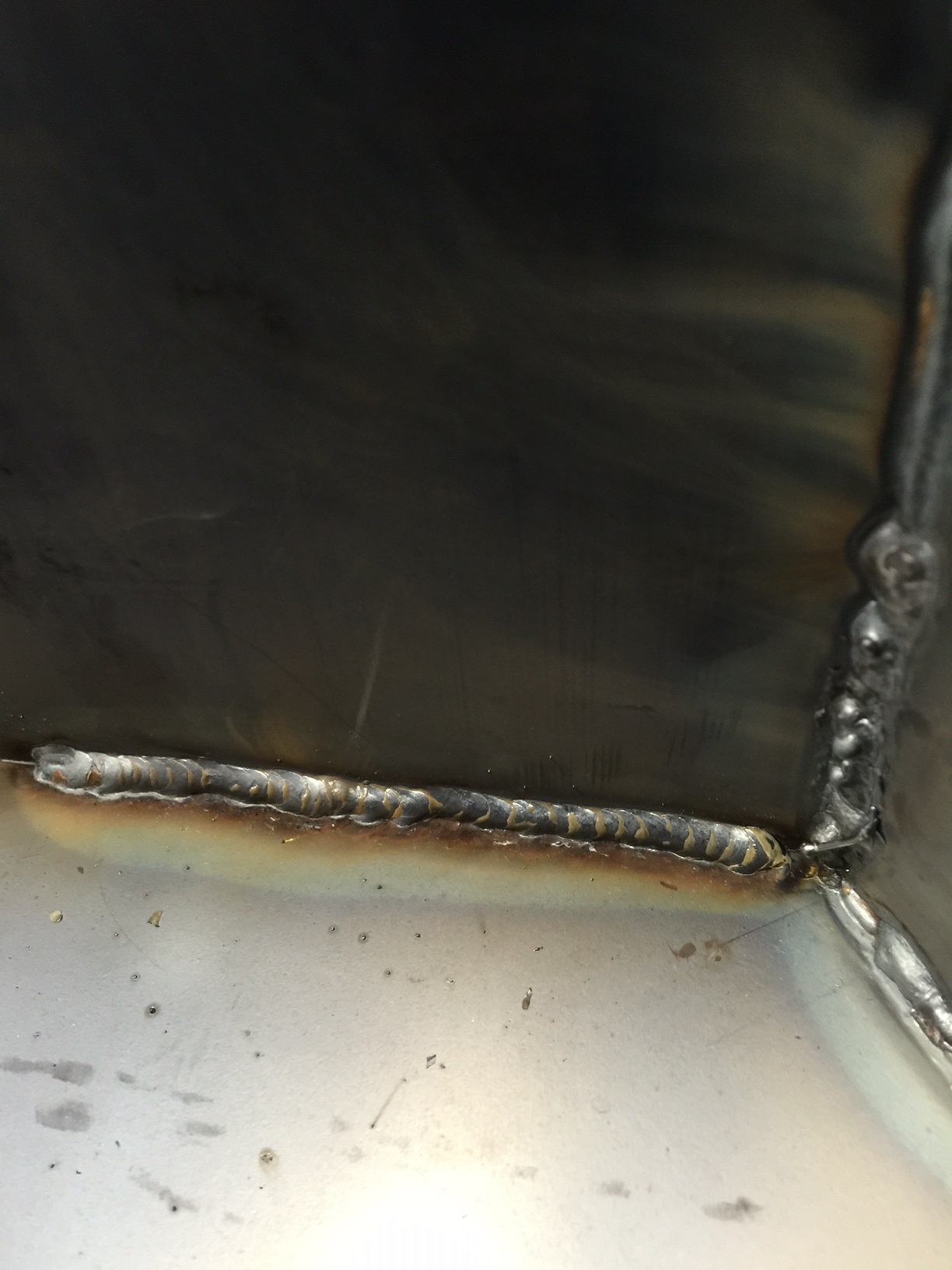

The fender wells needed to be welded up,, small tedious weld
Postby Bill » Wed Mar 18, 2015 4:25 pm

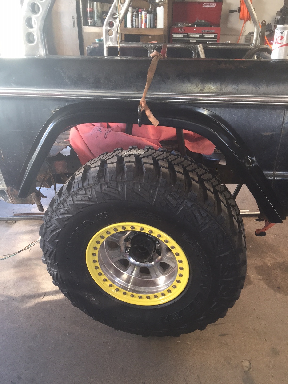

the finished product,,, this fender will be Armour coted ,,

Postby Bill » Fri Mar 20, 2015 3:49 pm

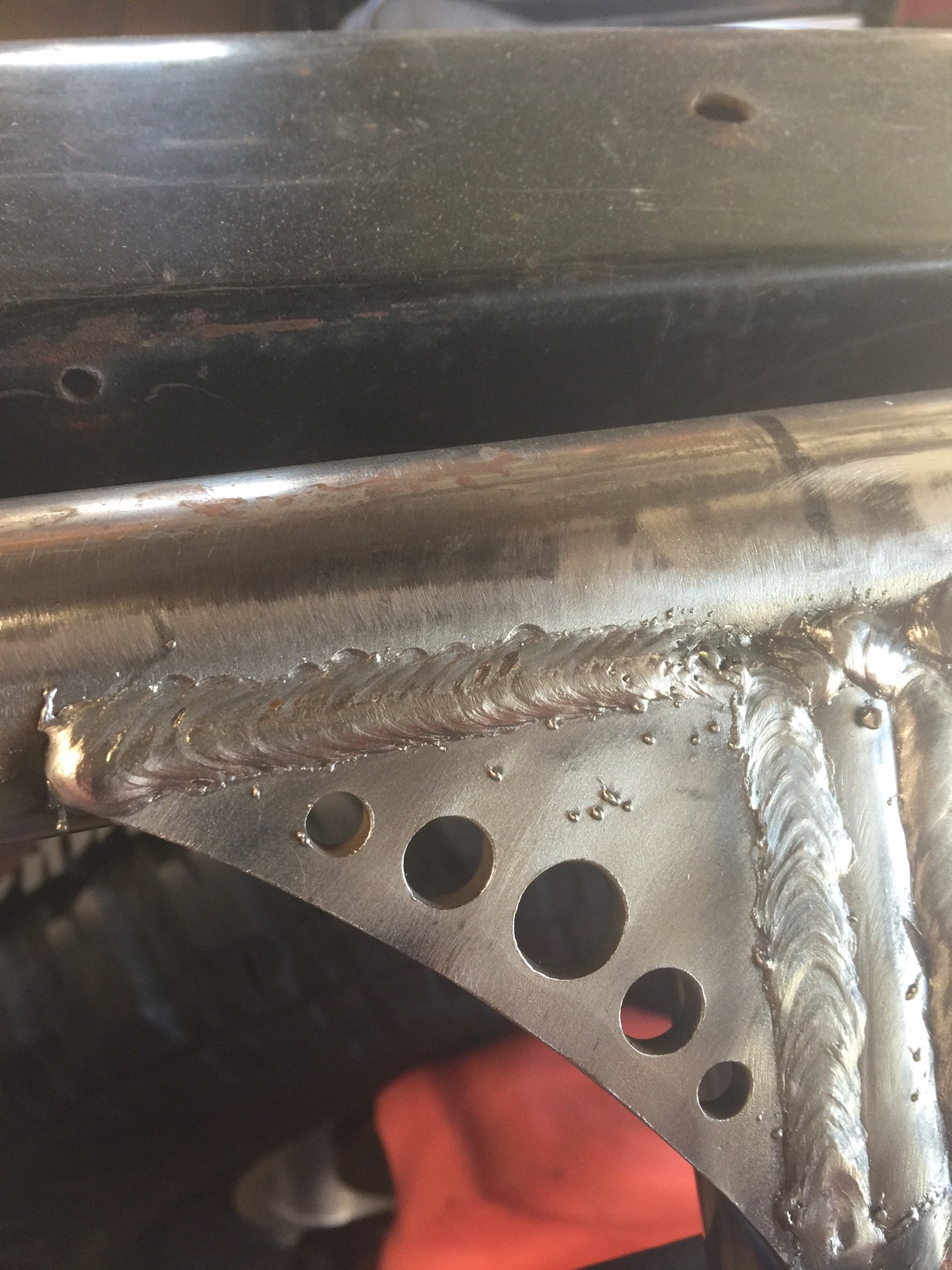

Ya I got lucky on that deal,, found it by accident. Wow , got some penetration on that baby

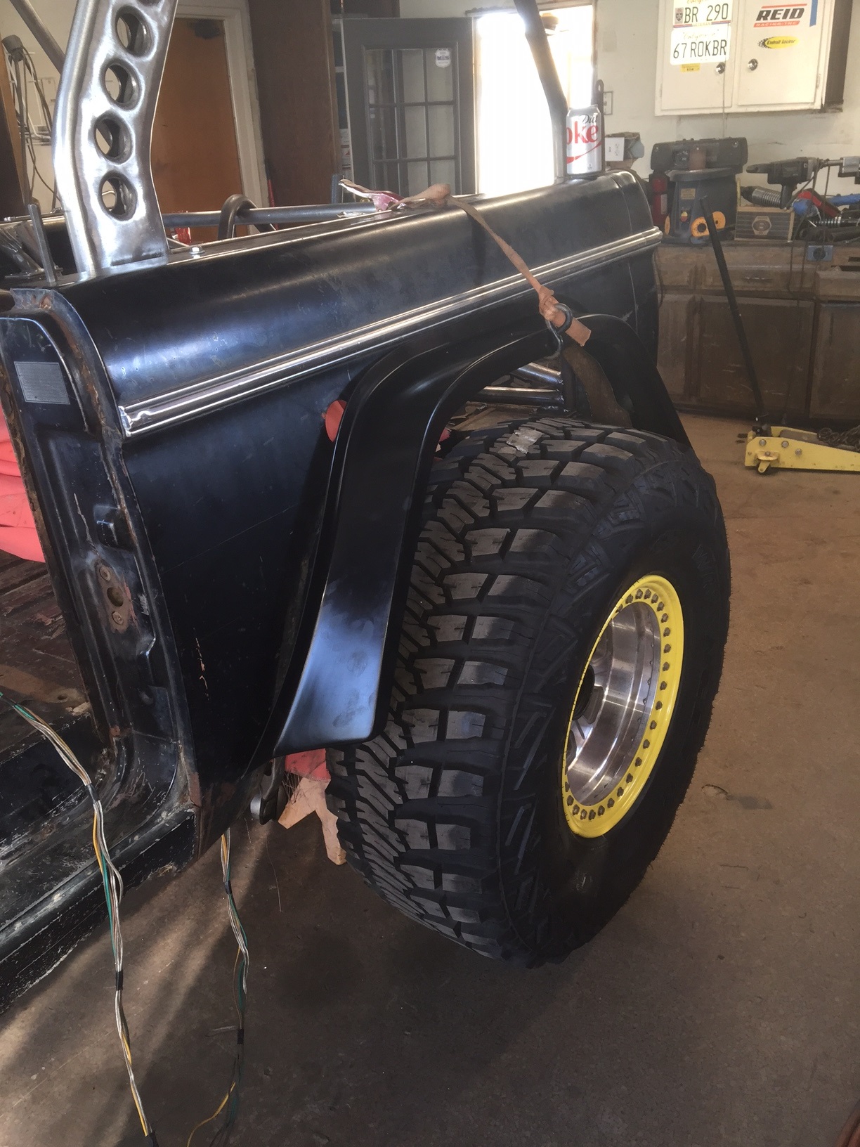

Postby Bill » Fri Mar 20, 2015 3:56 pm
Oh my gosh ,, I think these flares are going to work,, I feared my opening might be too large but I managed to stretch it out at the bottom and I think it will work , gotta do some small body work to it but allot easier than fabbing my own. Here is some I found on the net I liked look easy enough , yes I could have made them but a week of each one,, no way
Postby Bill » Fri Mar 20, 2015 4:00 pm
Coppers in our area are pretty used to lifted trucks and jeeps with tires that protrude beyond the fenders, so locale I don't think I will have a problem . Once out of town I'm sure I will fab up some light plexi glass to add to the polyurethane flares .

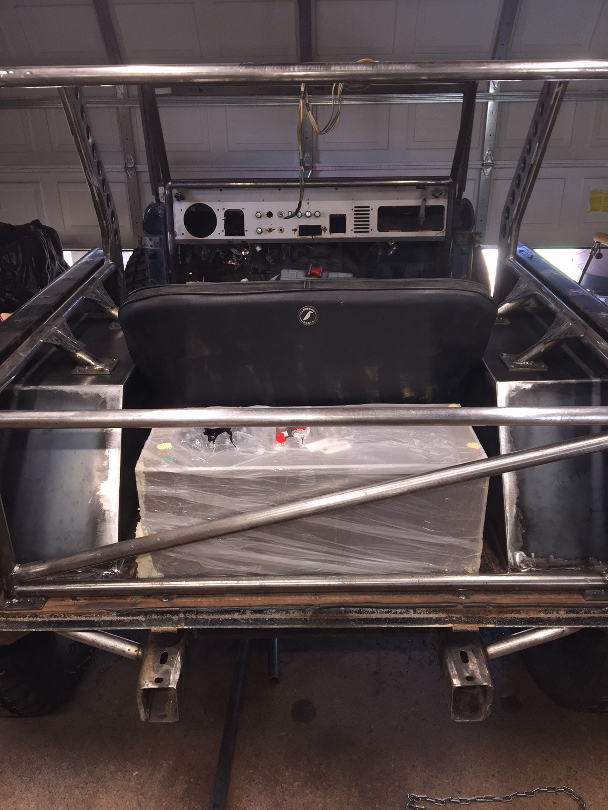

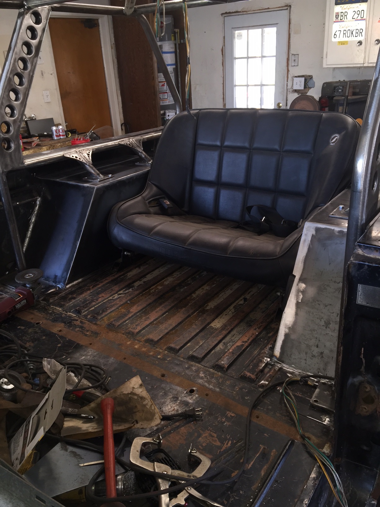

Postby Bill » Fri Mar 27, 2015 2:05 pm
finally welded in the fender wells , put in gas tank and seat. That tank says it's 20 gallon but it sure looks small huh??
