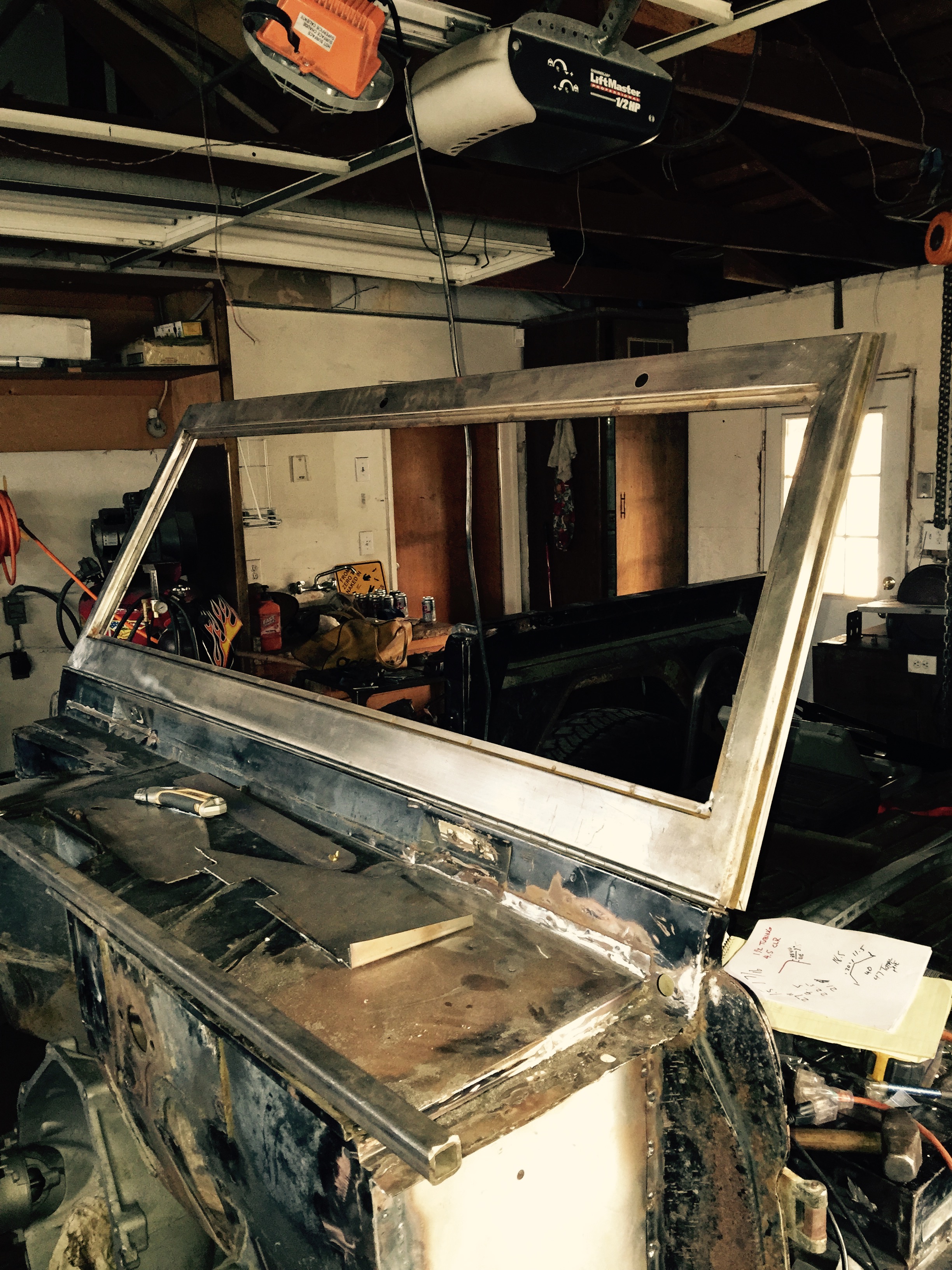

I did however mount the freakin windshield frame . The cowl was bowed where the new windshield frame bolted on . I guess from years of metal fatigue I hade to get a harbor freight ram and push the cowl up a tad to attempt straitening it . It worked for the most part but the hinge still bows a bit at the center , so I drilled and tapped the bottom of the windshield and pulled it down with some 5/16 bolts , it's not noticeable . I ordered some billet aluminum windshield knobs to pull it up in place it will look good ,, I think

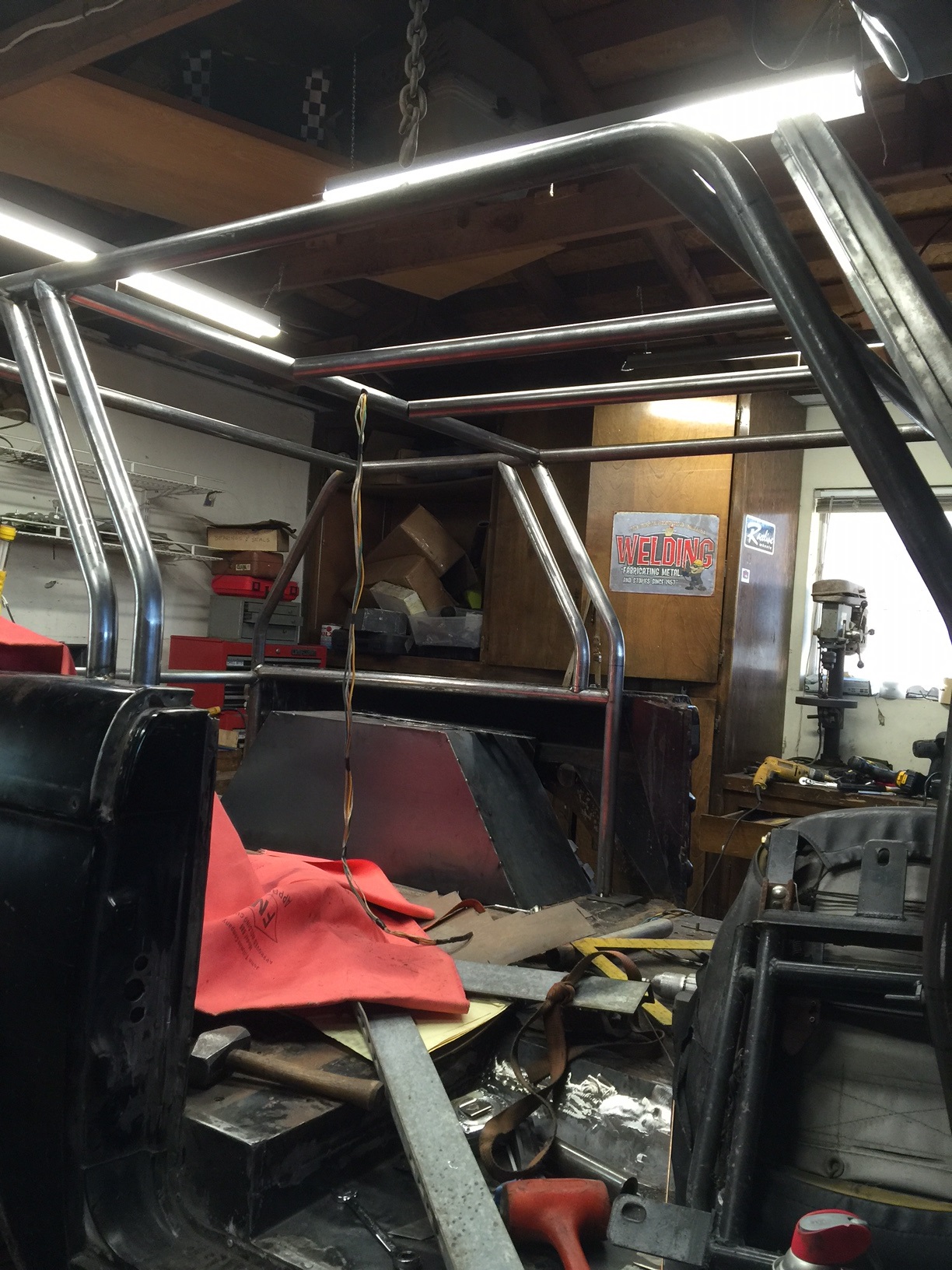

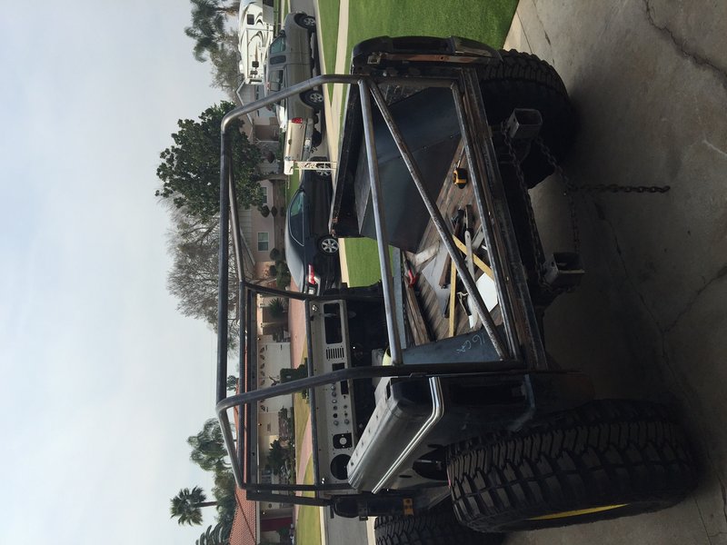

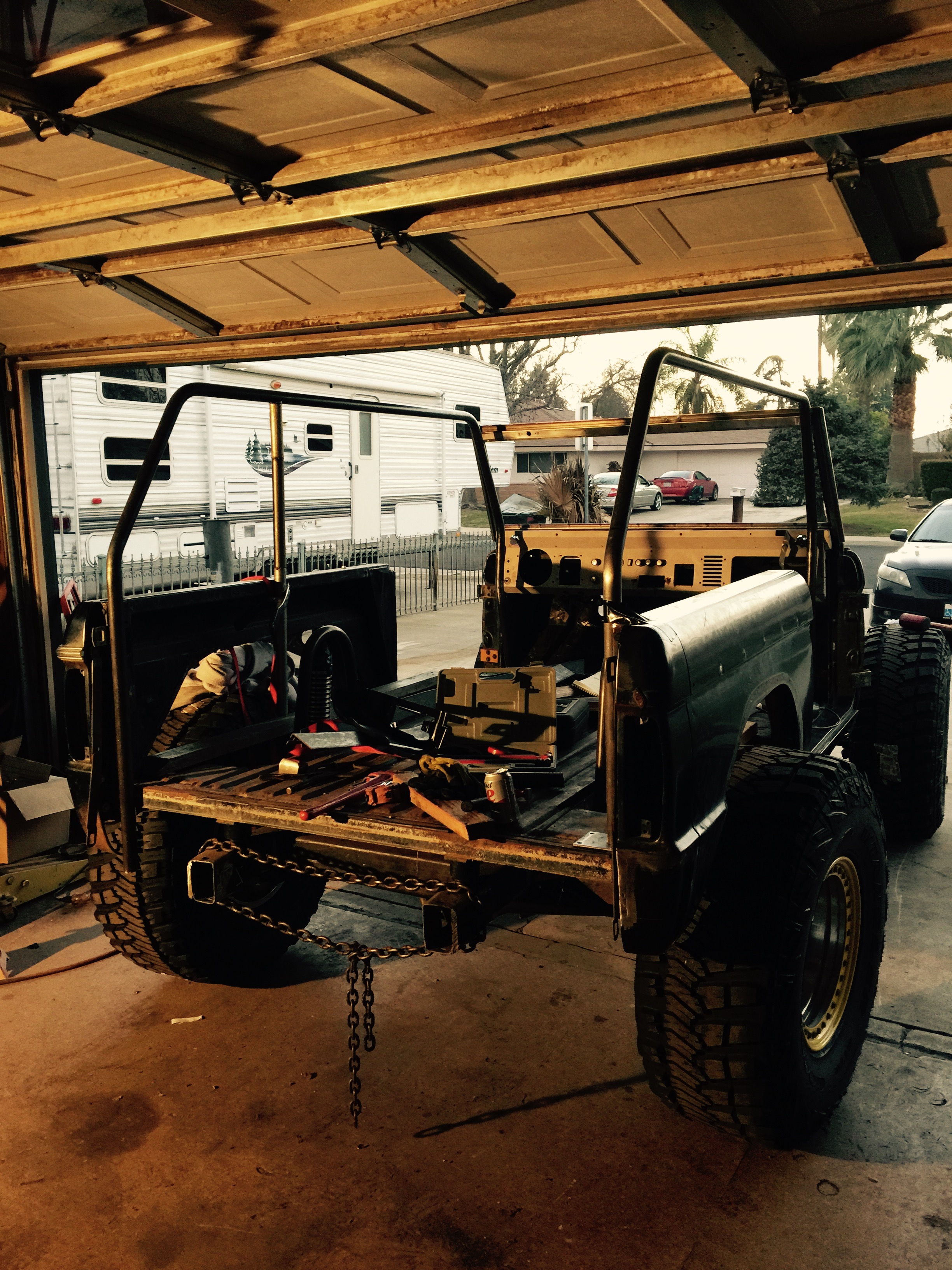

This is the start of the roll cage , I had such a hard time with this . I kept getting stuff crooked , wrong bend, blah blah. I took a day off after this day . It gave me a headache

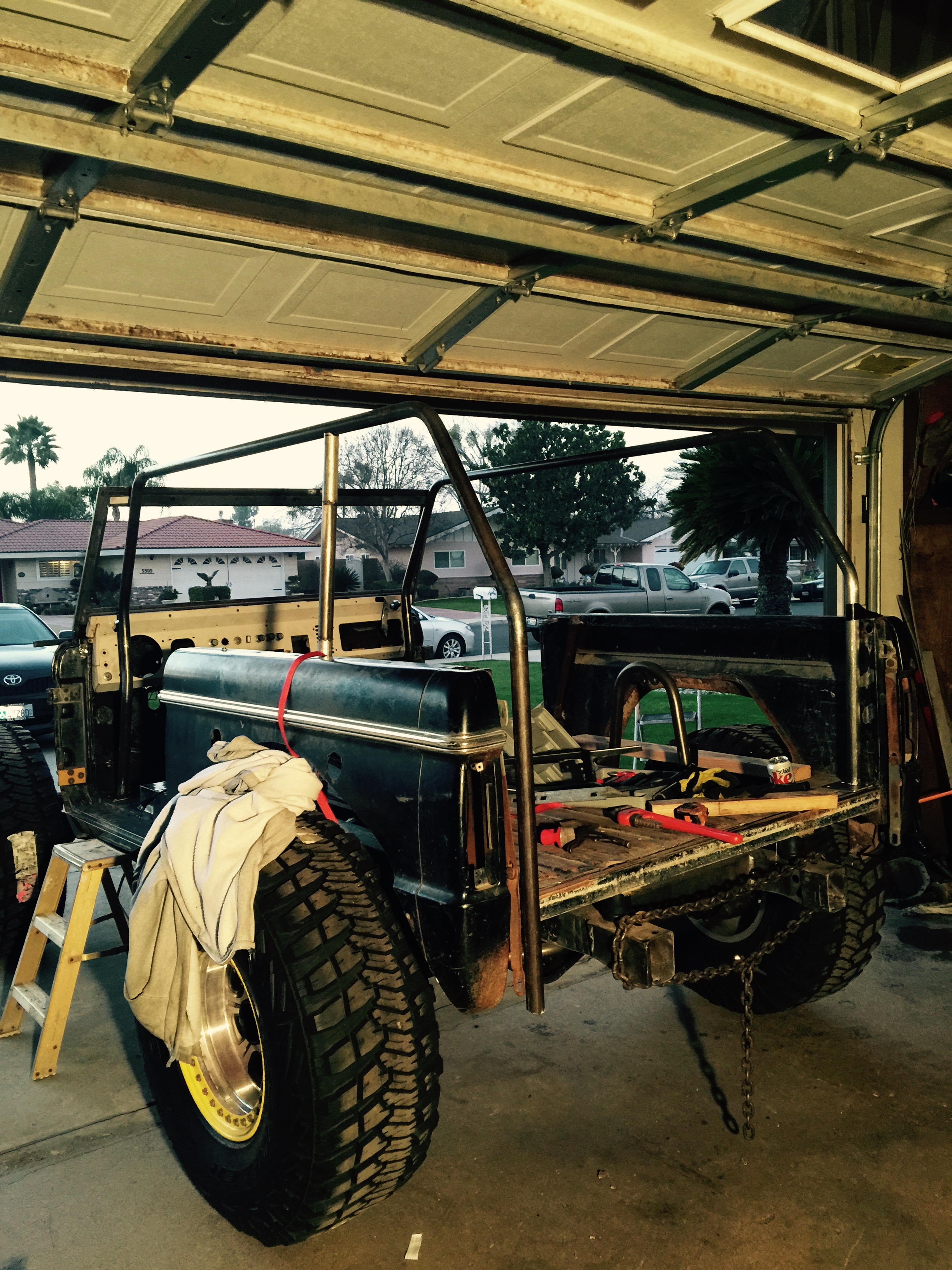

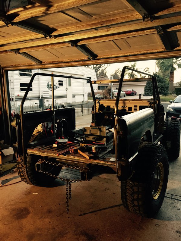

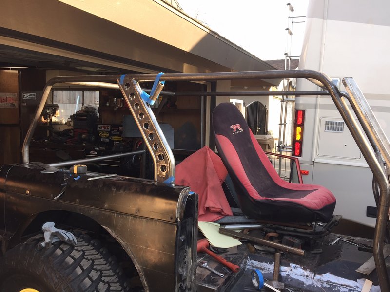

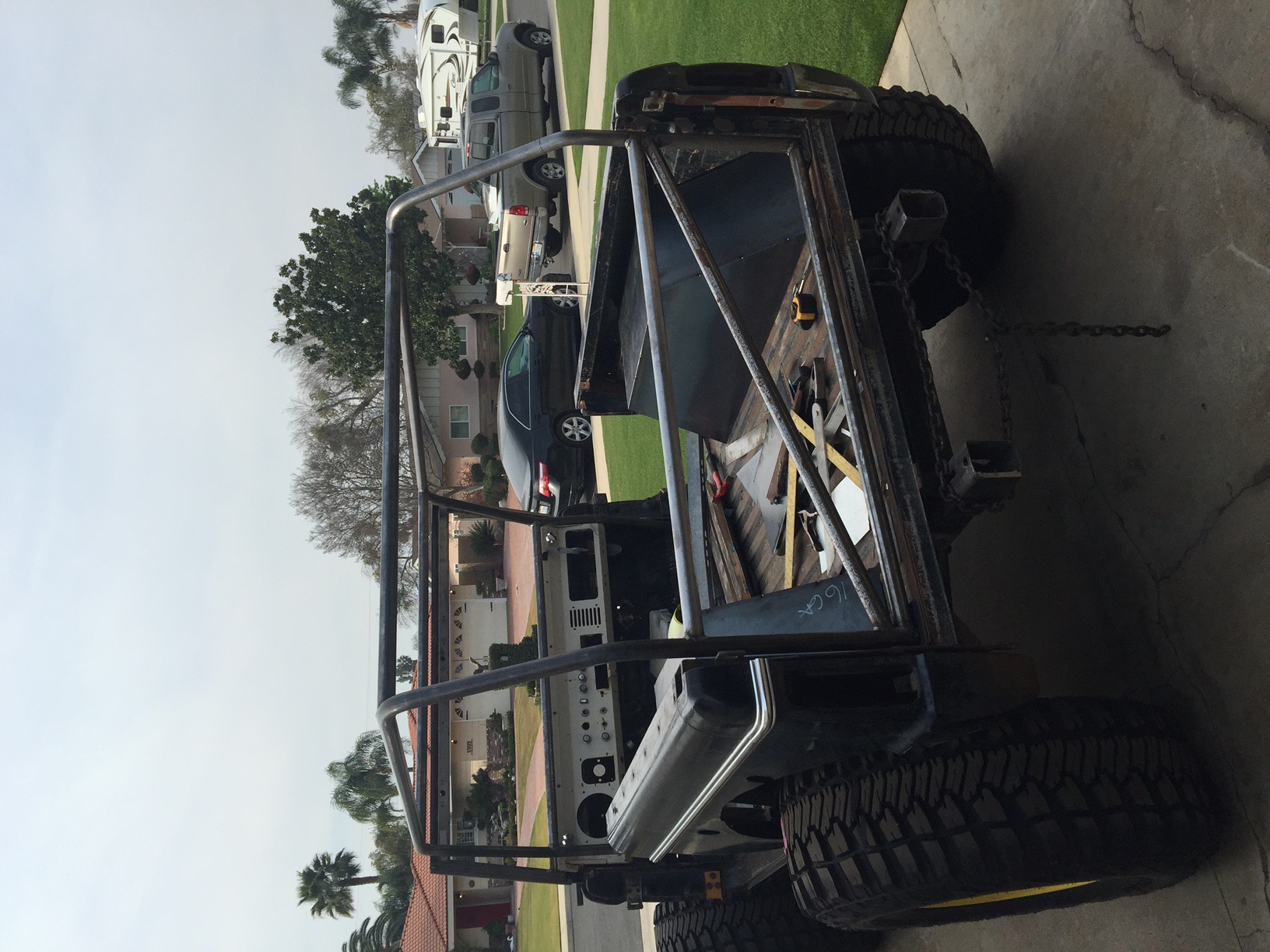

Finished the fender wells ,,, I stopped working on the cage because I realized the fender wells would be incorporated into the cage ,,, they had to be done first

So I felt it is a good time to start looking into dimple dies for the 1.5 holes I was putting into the support/deco plates that went between the up bars or "B" pillars as lots of folks call them. I knew that Robert Young had a home made version of a dimpler so I went and got it ,,, unfortunately it is just a cone shaped piece of metal with a harbor freight hand press thingy and it works in some applications but not this one . I apparently needed a regular dimple die . This is one of those lessons where you say , there is just nothing else that will do except the good stuff. I hate it when I can't skimp. Fortunately this is a sample piece.

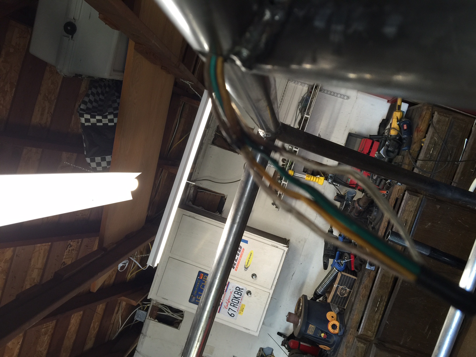

So I shopped around and found the least expensive dimple die , about 60 bucks and it's in route to me casa ,, so in the mean time I thought I'd work on the cage . I wanted to put speakers and a good LED dome light into the roll cage just above the driver/passenger heads. So that meant running wire or just drill holes and pull it through later . Problem with running wire through prior to welding is that it gets the wire really hot and burns it up . The problem running wire after is the sharp corners on the metal , I would have to spend tons of time making the holes with smooth beveled corners so wire would go through while being pulled. I opted for the burn up method. These wires are blurry but you can see the black ,,, ya that's burned up . So I was able to pull it through and repair the wire, thinking , well I can't do this again. I shopped around the garage looking for even the smallest of ideas to prevent the heat of welding from burning up the wires . I happen to see a piece of embry cloth laying on the work bench . You know the thick stuff that comes in a role about 2 inches wide? It's really thick paper with sanding material on one side. I welded on some sample metal and put the embry cloth against it , it smelled sort of like leather burning . I picked it up and there was nothing . The embry cloth withstood the heat of a fresh weld . So I proceeded to wrap the wire with embry cloth sand paper putting the sand paper side next to the wire as to prevent slippage. I stuck the wire back into the hole and will weld it today with the help of running water out in the driveway. I will weld about an inch then cool it with the water hose , then continue like that till it's welded up . Prior to putting the speakers in I will test the continuity of the wires, probably with a 12V battery.
