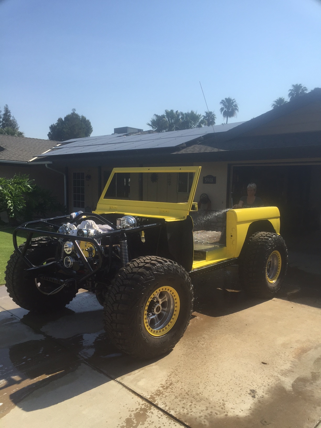

Finally put the body on , friends and neighbors showed up to help . Used a hoist to lift it up and get it off the rotisserie

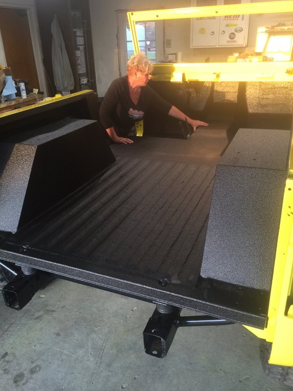

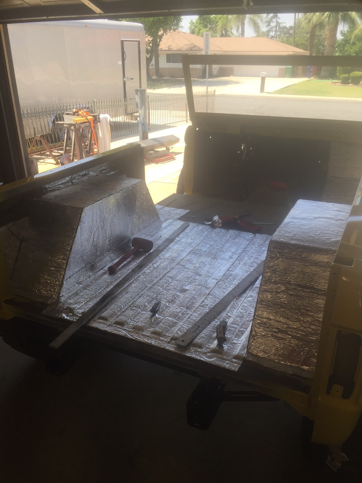

Put in some frost king insulation on the floor from home depot . Dyna mat was way too expensive. Jeff at ARMA coating on Buck Owens Blvd said it would be ok to do it .He regretted it afterword. It didn't stick in some places and he had to re-do one spot. All in all we are happy with it. The insulation will help allot with the engine heat this summer since I have air in this one , it should work allot better.

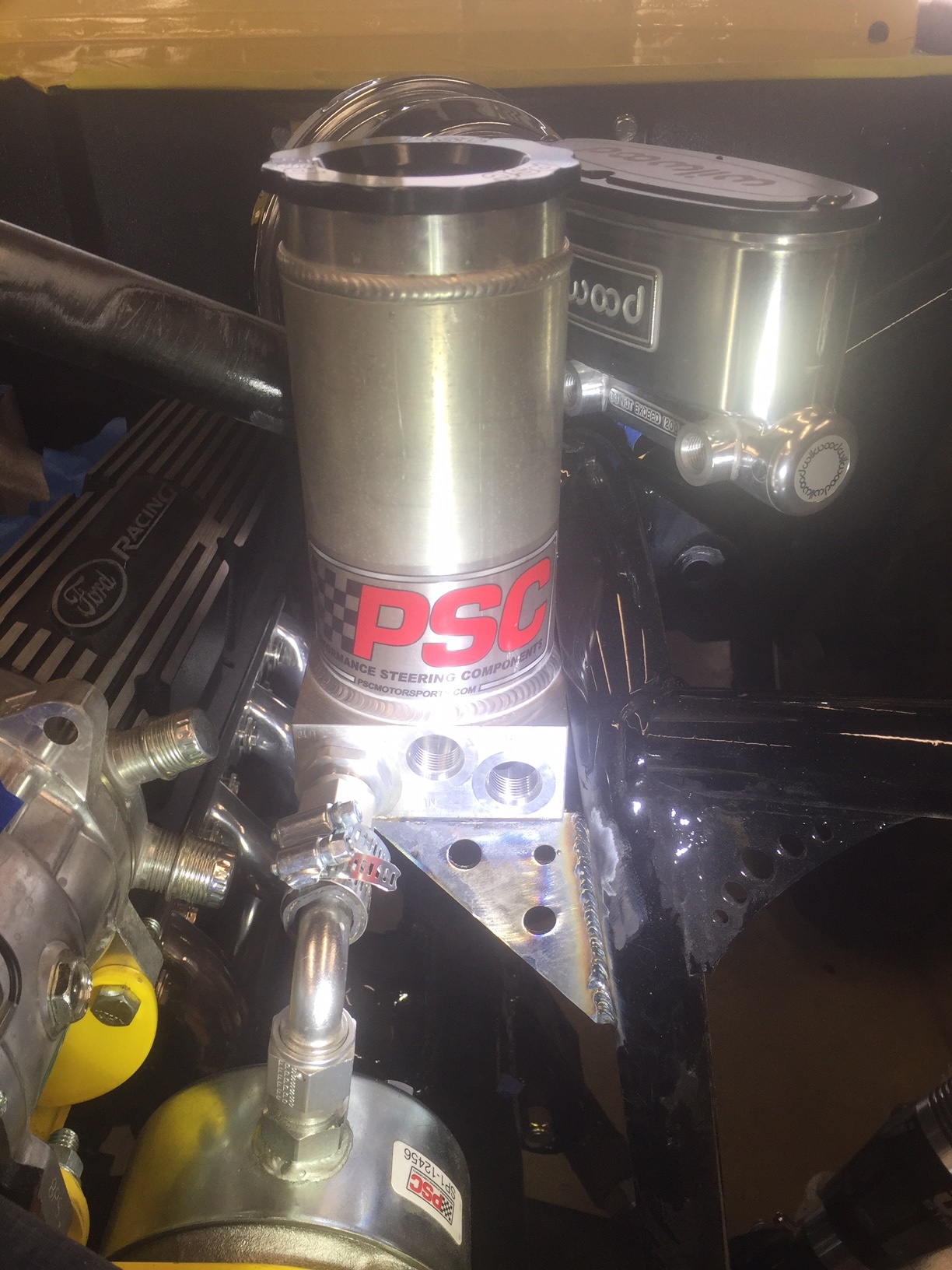

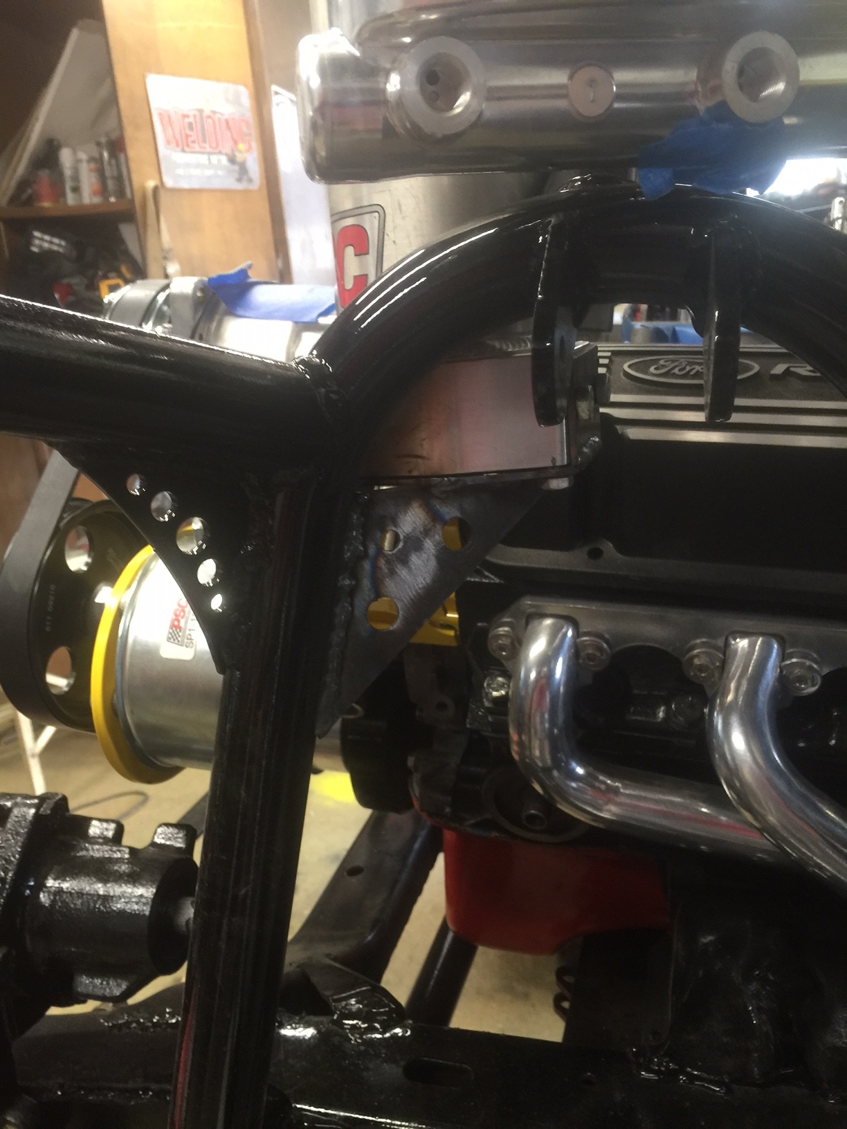

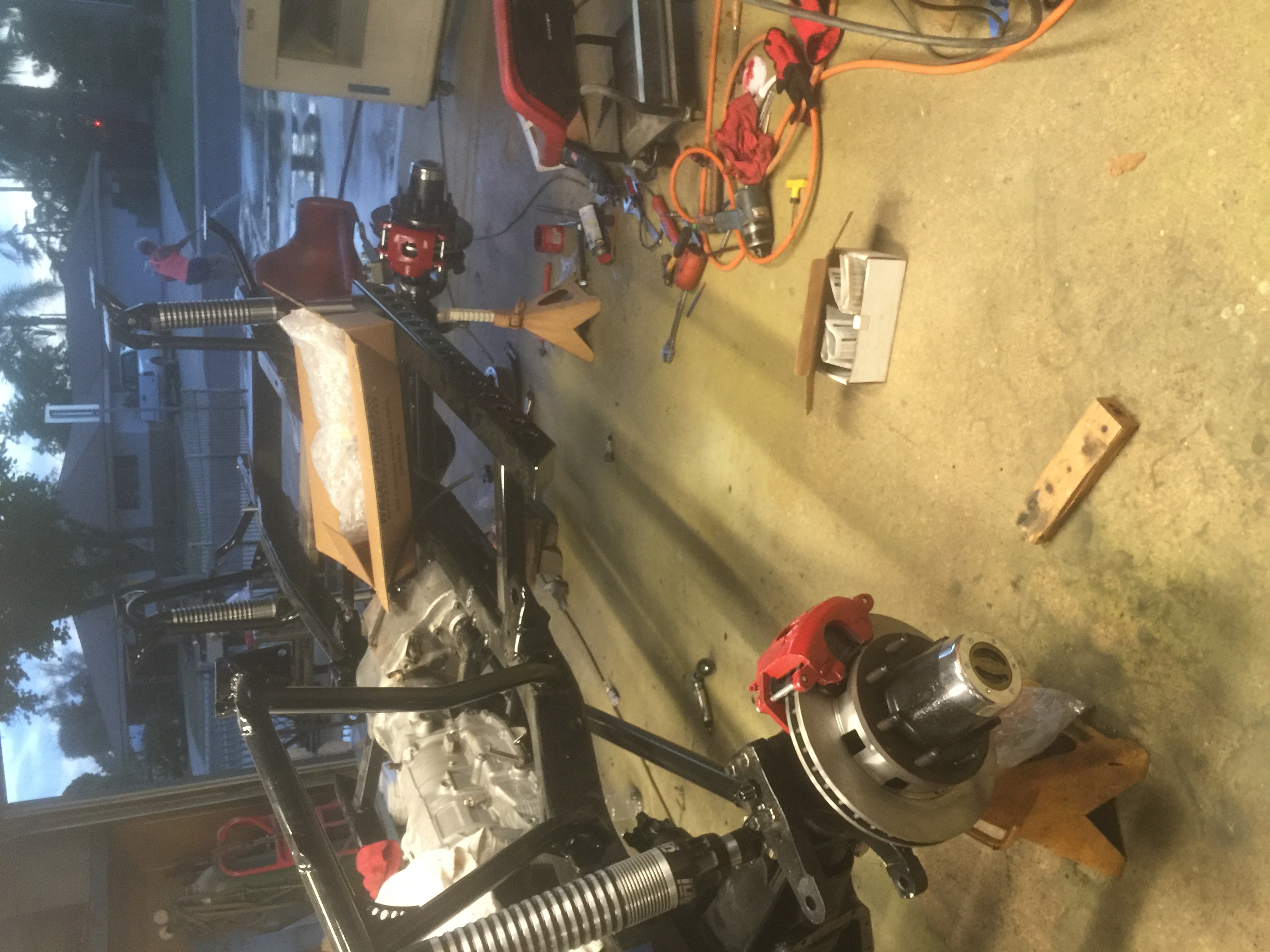

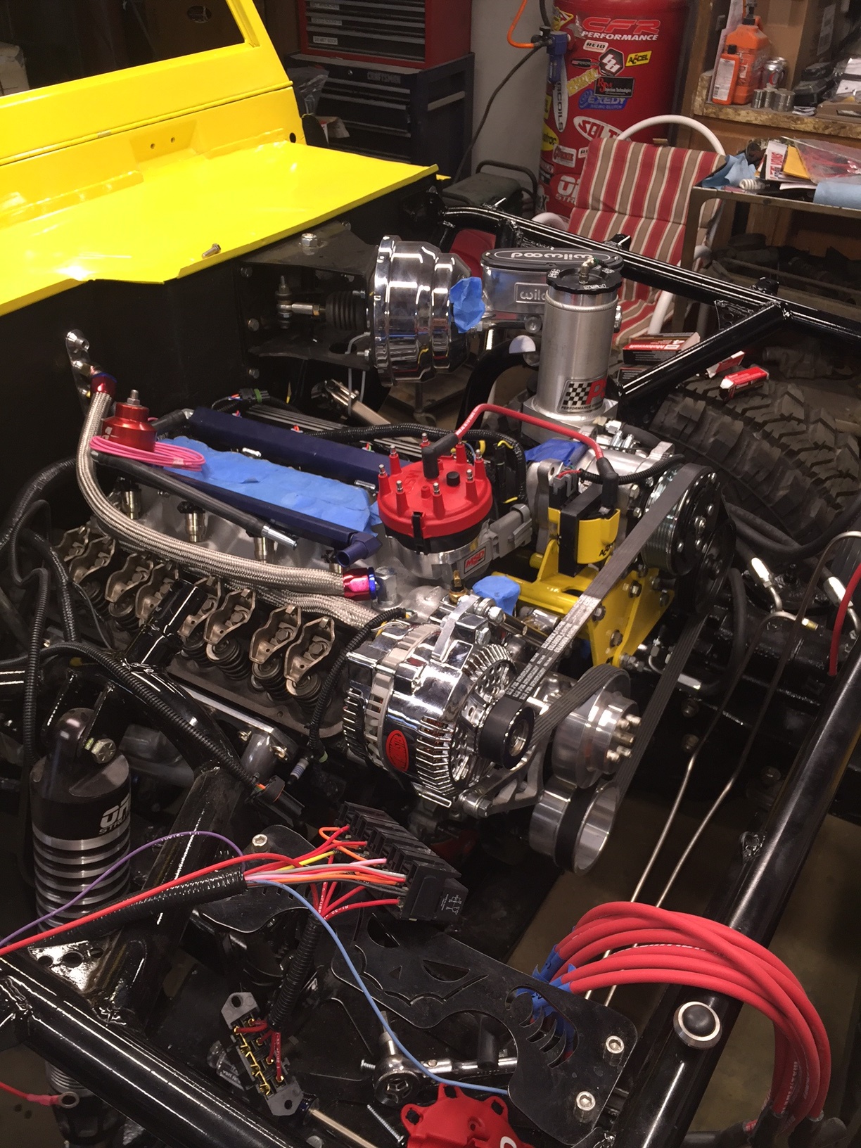

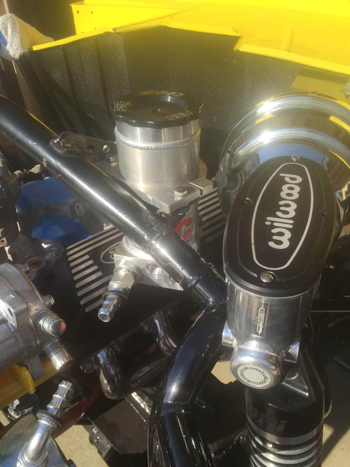

I had to cut out the brackets in the second picture for the PSC P/S reservoir . I thought it had clearance and it freakin didn't. So I settled on the one in the first pic. It took all damn day to cut one out and re-fab the other one.

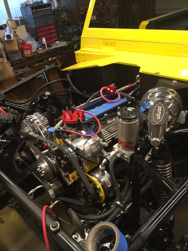

Working like crazy to get the build done by fathers day. engine pics, did the hydraulic lines, tranny lines, rear steer , needed: fuel and brakes. Probably one day for each of those. Maybe 1 1/2 on the brakes , scrounging fittings. My friend and wire guy will wire when he is home from his vacation. In England of all places, I hope he doesn't get blown up!!

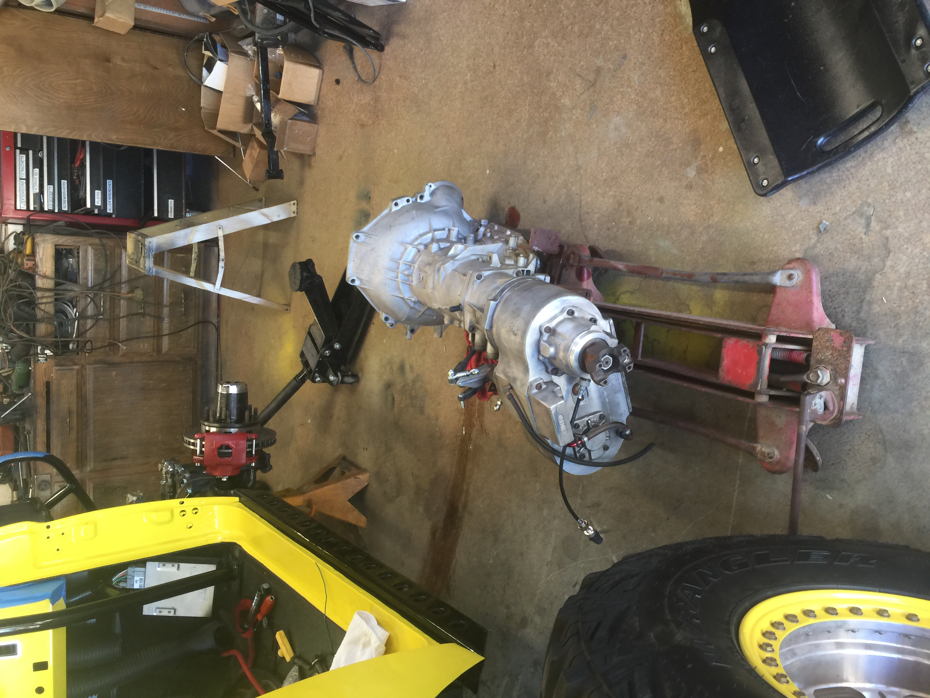

So, long story short, never made it to the car show due to a few set backs which I will explain . One was the tranny . I'm putting in an AOD, fords first manually or mechanically operated over drive transmission. I put it in when the body was off so it was easy. Once we started the motor it idled fine but would not rev . It seemed it was working against the torq converter. Called a few people including Tom at Gils transmission who initially overhauled the thing. The only solution was to pull it out and give it back to Tom at Gil's
Turns out the torq converter was engaged while in park. The valve body was installed incorrectly by a guy that Tom had fired . Tom said he was getting trannies back 2 years after the guy left. Mine was one of them . He fixed it and I put it back in . It worked fine . Now my brake story
