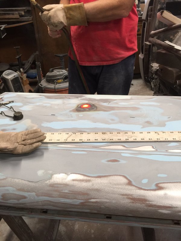

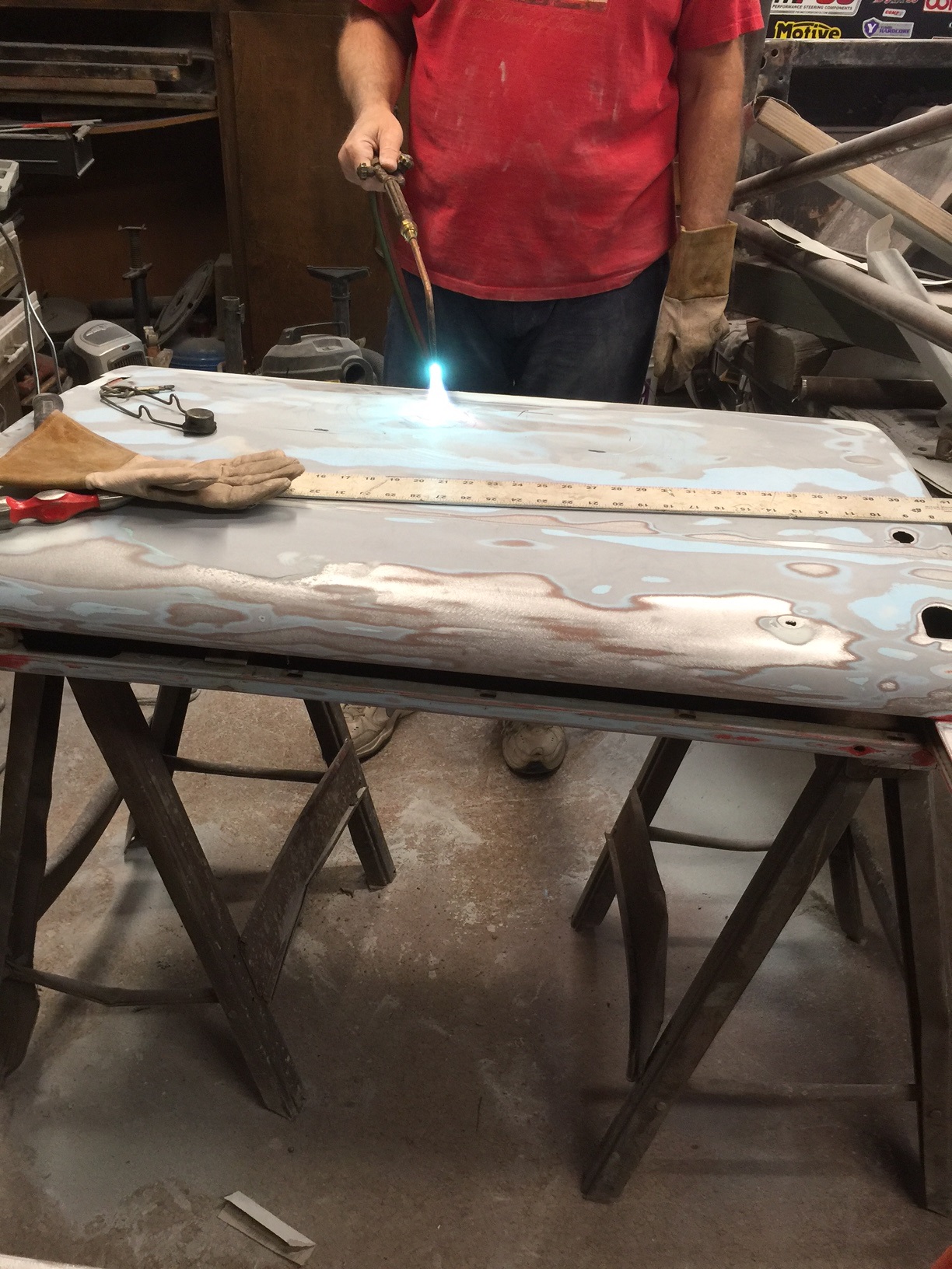

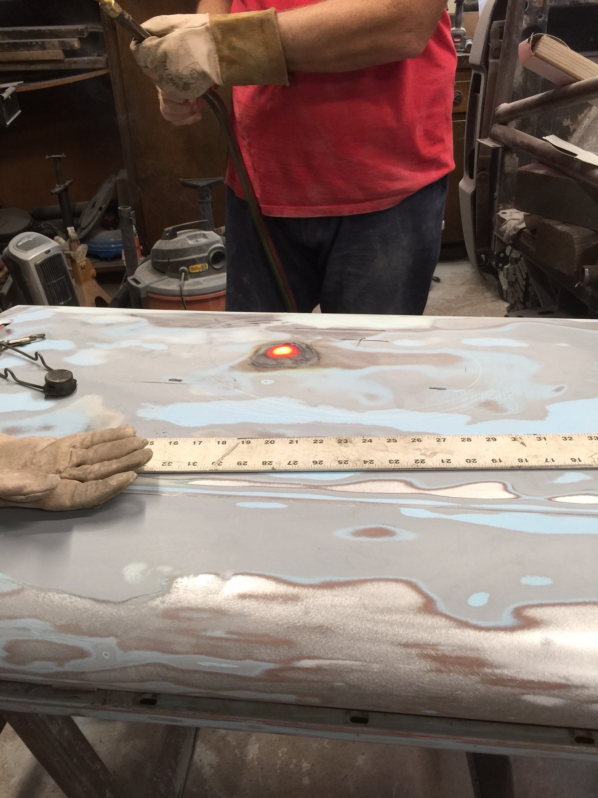

Postby Bill » Mon Jan 09, 2017 5:39 pm

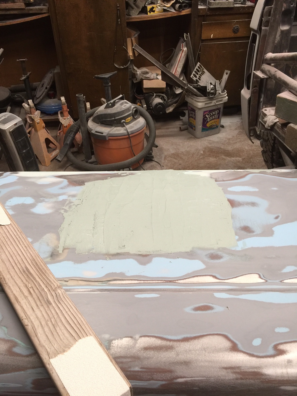

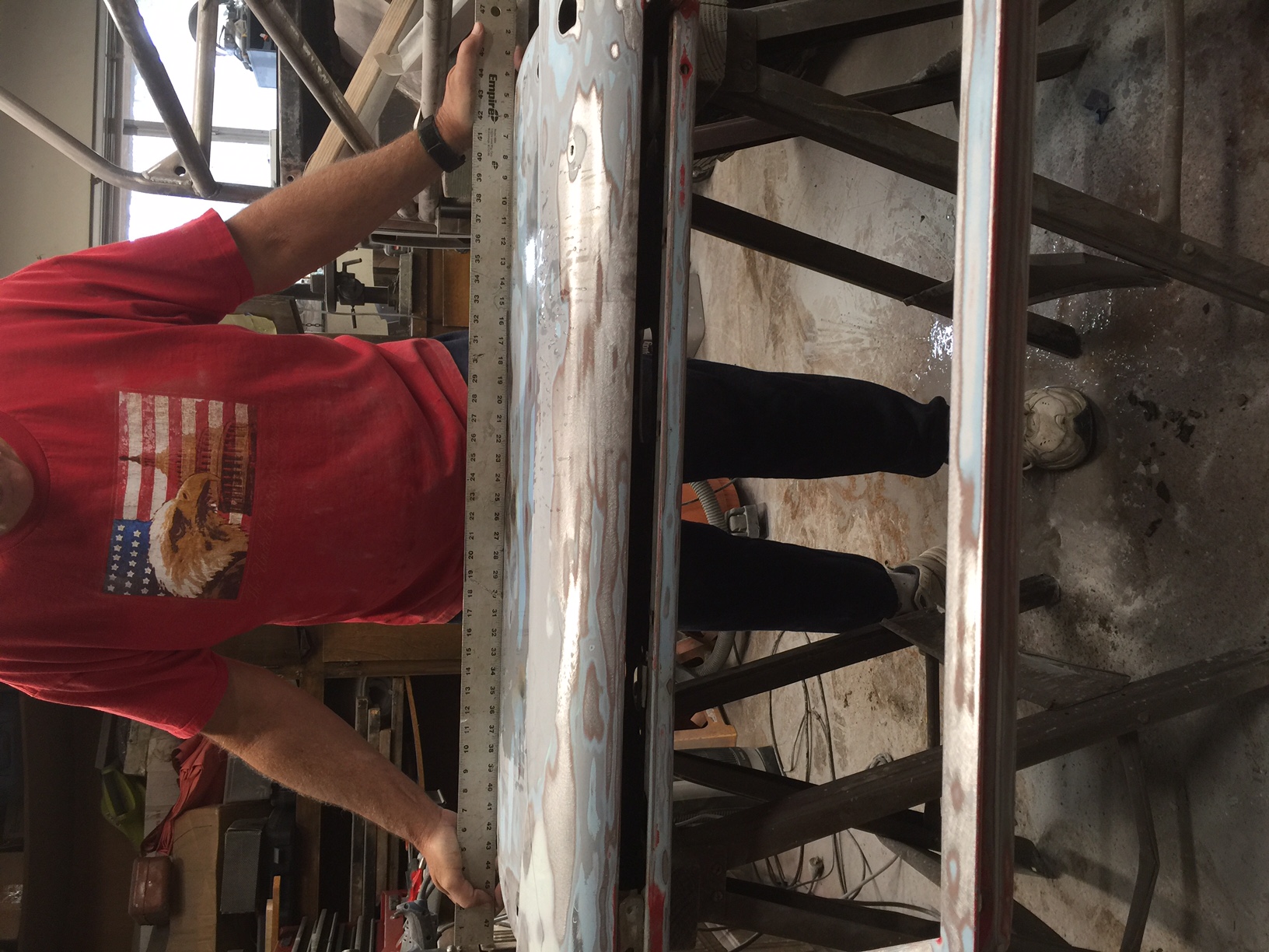

Used my torch to heat up one spot then put a super wet dish towel on the heated spot . It immediately shrunk up I did it in several places , you can see from the yard stick laying flat on the door that it sucked it right up.
Postby Bill » Mon Jan 09, 2017 5:42 pm
THEN TO CLEAN IT UP WITH BONDO , BONDO WILL BE ABOUT AN 1/8 IN THE THICKEST SPOTS

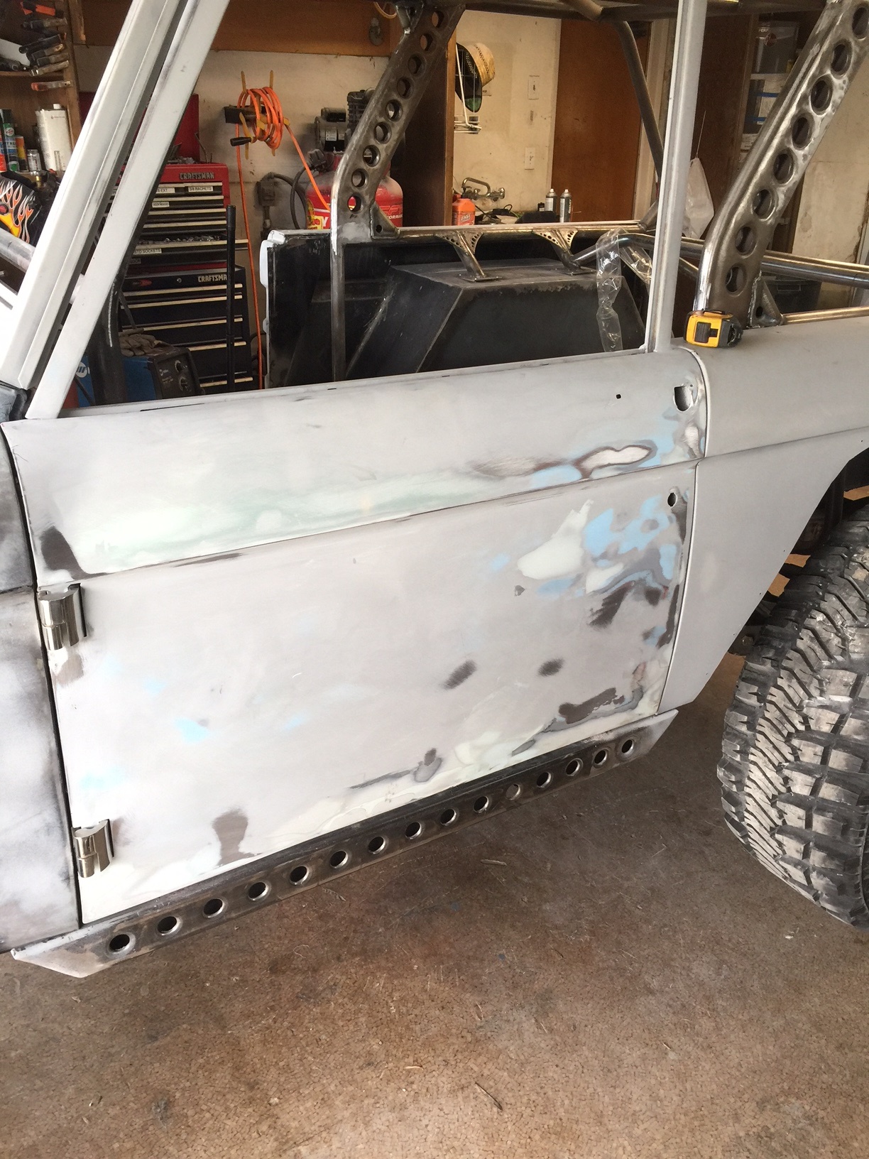

Postby Bill » Mon Jan 09, 2017 5:53 pm
In the mean time , I was in dilemma about wind wings and how to make them look good. My brother cleaned his all up painted them , actually put new glass in them ,, big job . I searched for an alternative . I knew I had seen a place that made one piece glass windows for doors. I searched for several days using my keen investigative skills I finally found them at a place called mikesmetalworx.com . The guy had a friend with a bronco and they decided to design a one piece window the kit was like 700 . Came with all the goodies , new regulator , all the rubber molding all brand new. So I broke the piggy bank using a harbor freight autobody hammer and bought them. They look like the pic .

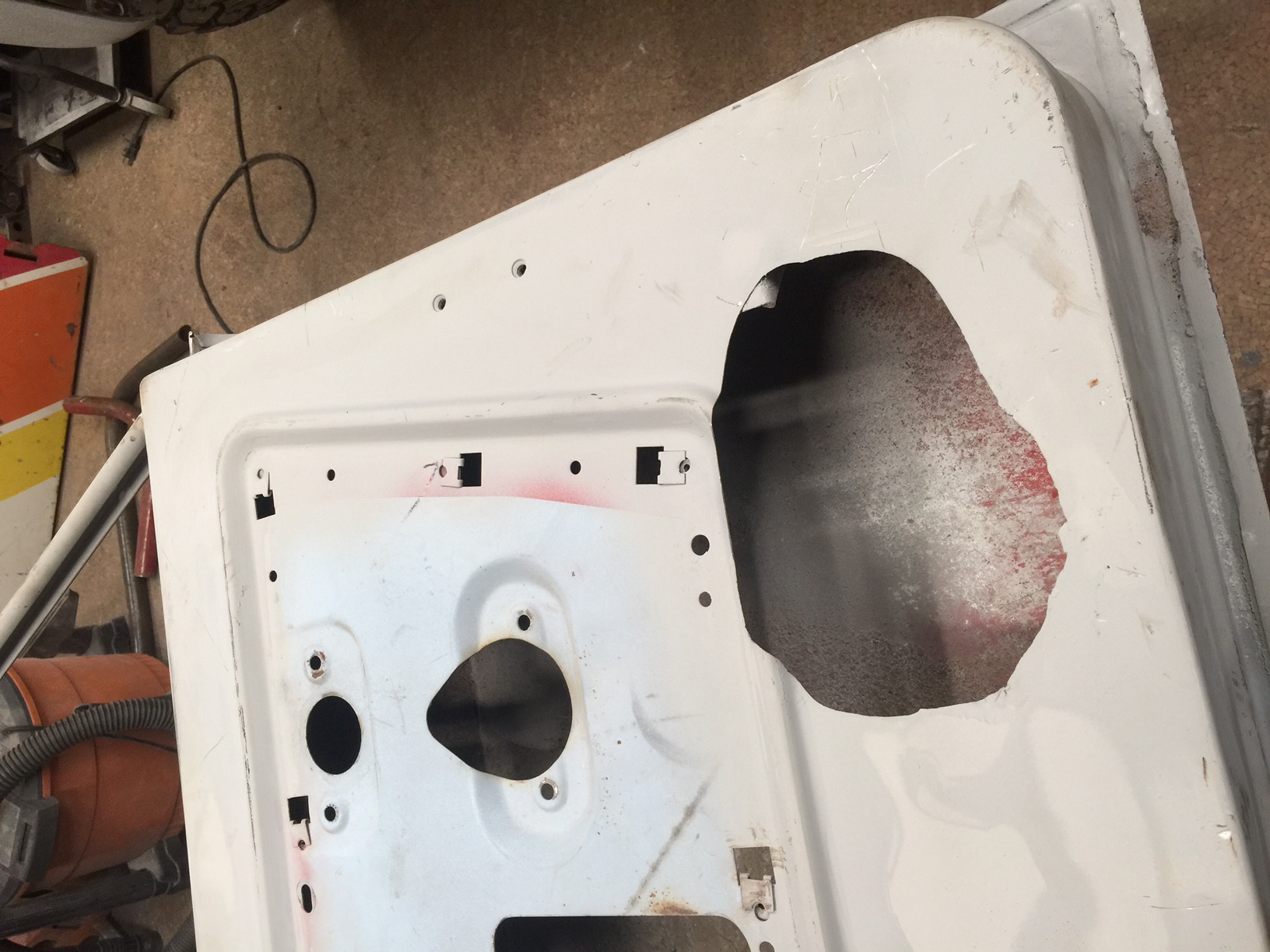

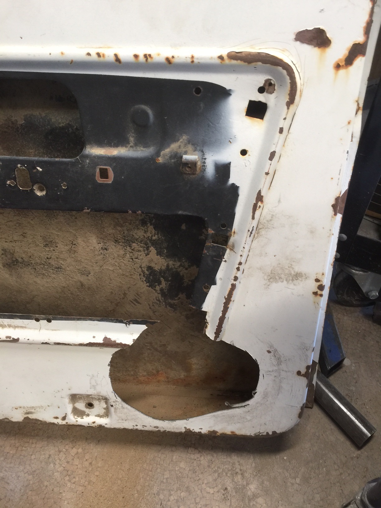

Postby Bill » Wed Feb 22, 2017 10:00 am

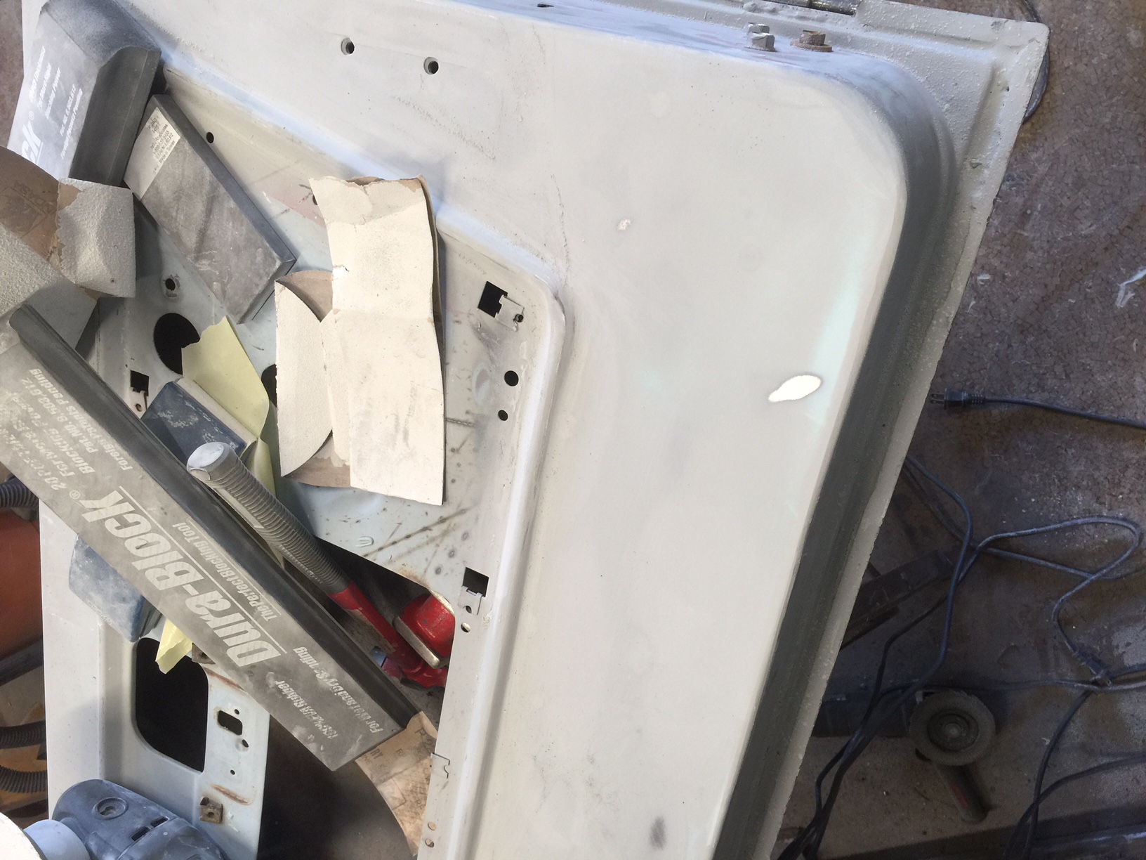

So fixed the speaker hole in the door. the one pic op above , where allot is missing is my donor door. The other hole you see is the door I had to fix, and then the finished product.

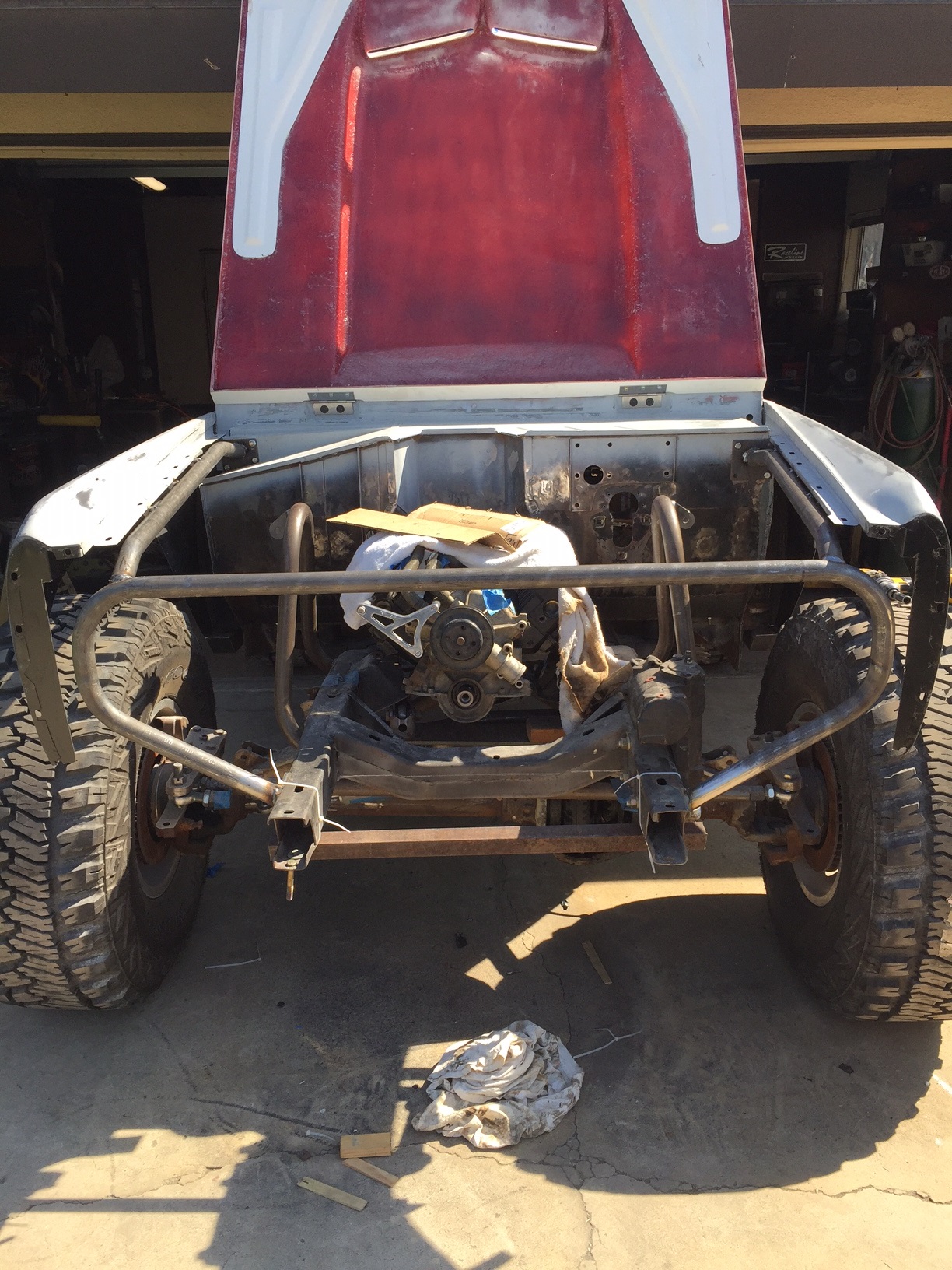

Bought DOM pipe yesterday , putting motor in today just for set up , I will keep you updated.
Postby Bill » Tue Mar 07, 2017 8:36 am
Put the motor in temporarily so I could build core support and mount the radiator, fan, AC condensor and mount the battery. Here is the DOM pipe I bought ,,, HA HA I only had to do it once ,, That's a rare day.

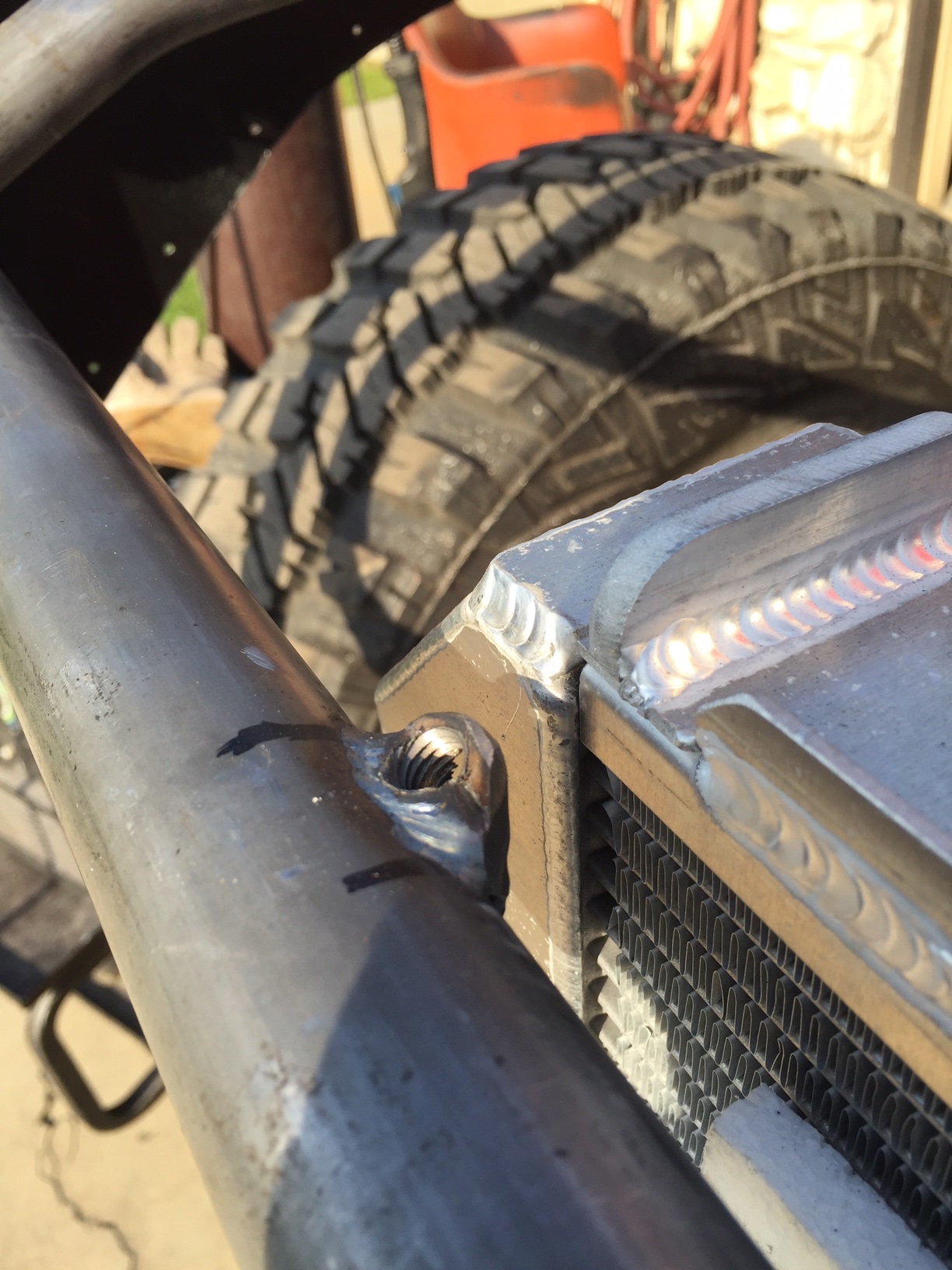

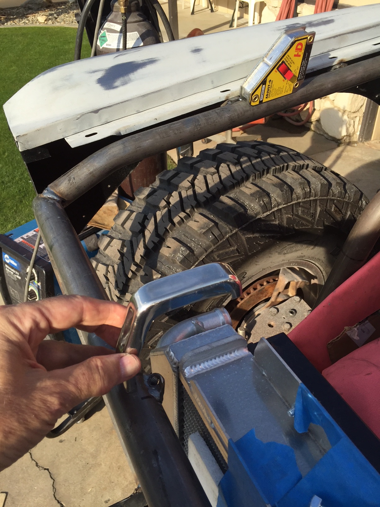

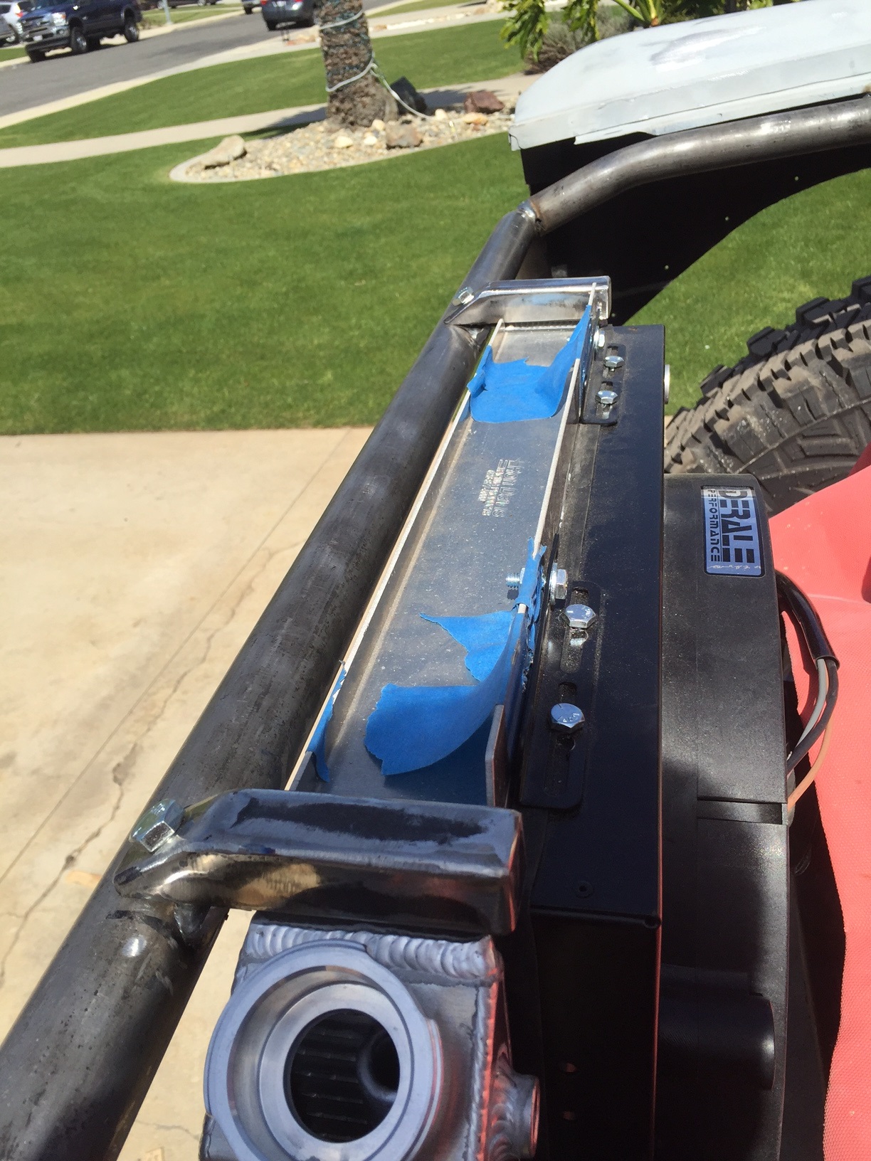

Postby Bill » Tue Mar 07, 2017 8:48 am
I bought these little shiny original radiator (bottom pic) do dads from Wildhorses 4x4 I tried for 2 days to figure a way to make them work. To no avail I failed. I did use the rubber in them , then fabbed some out of some 1x1 inch Sq tubing (middle pic). I stuffed the rubber inside those things. I used a piece of round 1/4 wall pipe to weld to the the bar (top pic) for the radiator mount then I drilled and tapped it to 3/8's. I'll get a button head stainless from budget bolt and polish it to spruce it up a bit. I will powder coat these yellow.
