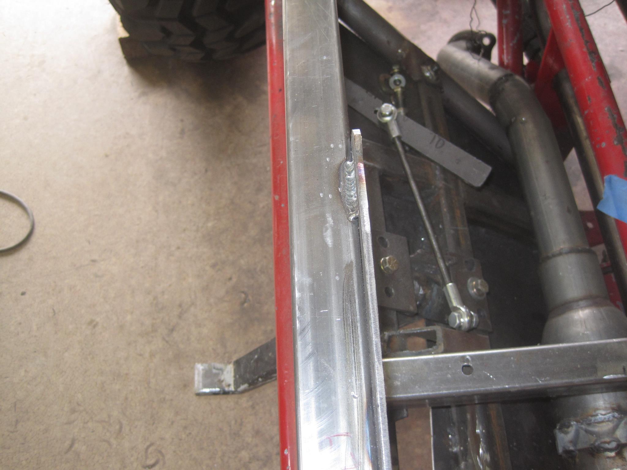

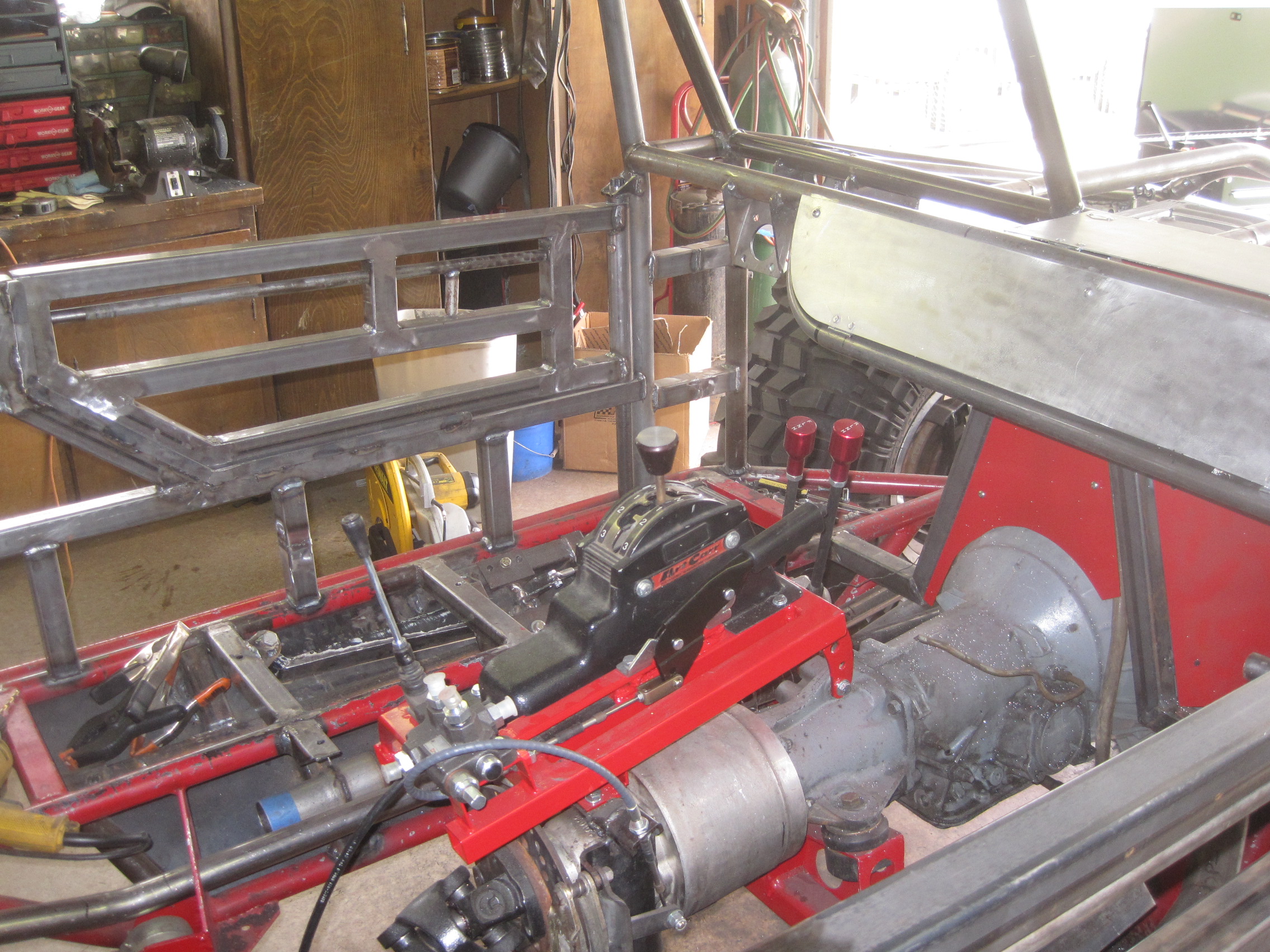

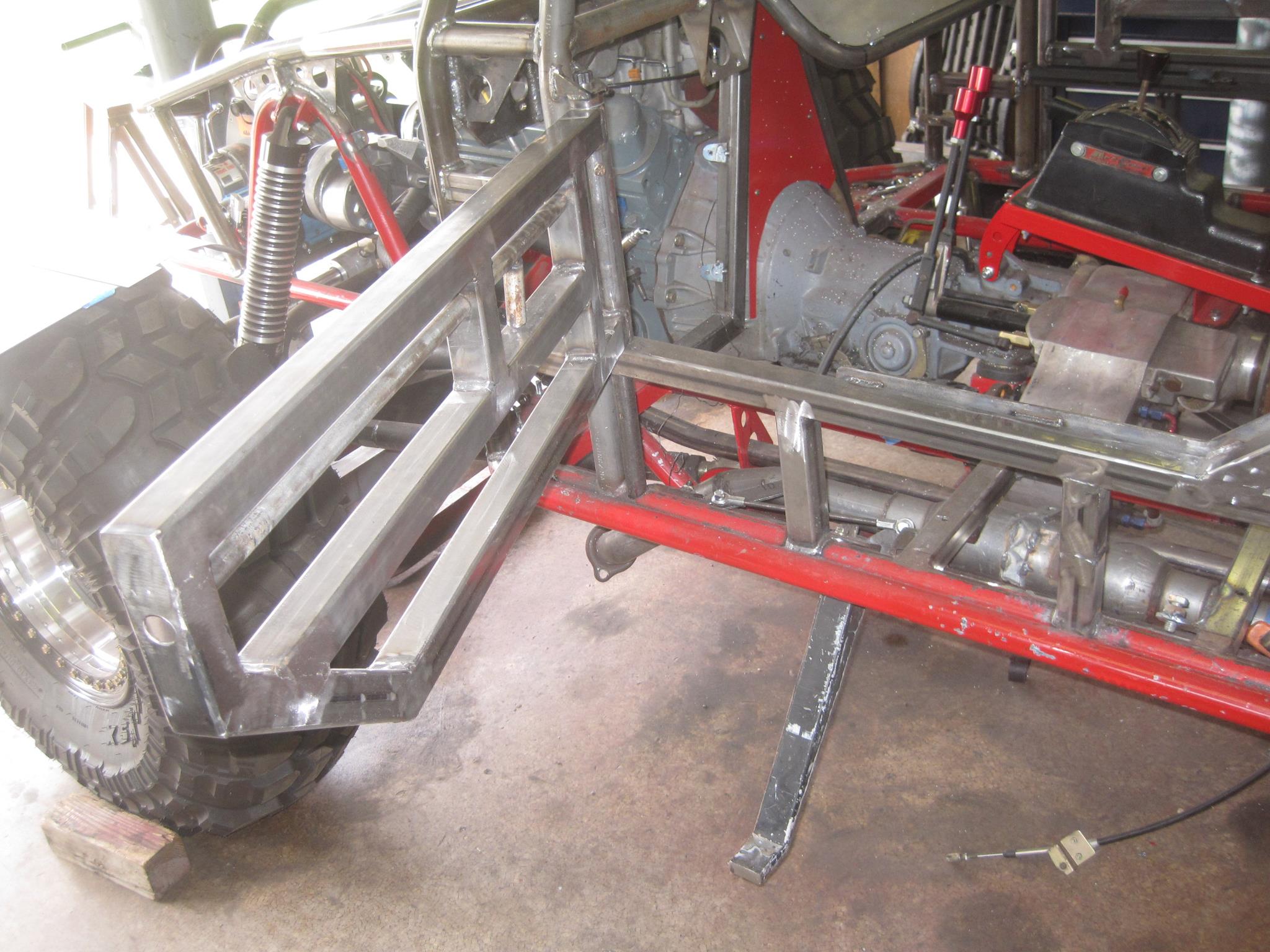

I bought this atlas used and it came with a diff brake on it but no apparatus to make it work. I ordered a Chevy vega handle and after market cable system to hook it up. Mounted it directly to the tranny I never intended to have a tranny cowl. Just a firewall to stop the engine heat. You can also see a fabricated door, I intended to have doors from the start as well. Marsha needs a step so I wanted another step just not an electric one on a linear actuator like the blue bomber. It was too much of a head ache and I was constantly driving off with her step in the down position (I think bloody Mary's may have had something to do with this). So I wanted the step to come up when the door closed. The door uses a one inch solid round bar as a hinge at the bottom of the round stock bar where it goes through the frame, is a lever which works the step. If you look close you can see the 2 heim joints and the all thread which connects them. The step apparatus I stole from my old buggy and modified it to work with this one , saved me some fab time.

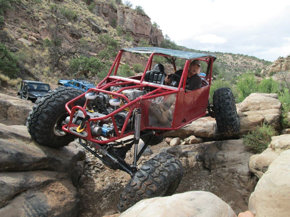

I guess we are all headed to St George instead now. Me, Cliff, Joey, Bob, AJ, Randy, maybe Josh Mouton and Wayne. AJ may go on to Moab from St George . I have a reservation at slick rock but Im afraid to cancel because I could get a wild hair and go after St George . I would need a ride , as in trailer and tow vehicle to get to the trail . These are older pics as I'm sure you know I've been to Moab in this rig already .

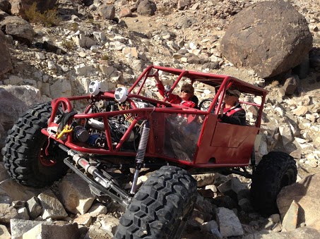

Got it done went on some runs , broke all four ford knuckles , I actually had the welded in gusset in the suspected "weak part" of the ford knuckle which became the actual weak part . Probably something I did , I'm notorious for jacking up my own shit. Bought Ried Racing knuckles for all four corners putting the ones on the front starting tomorrow already did the back.

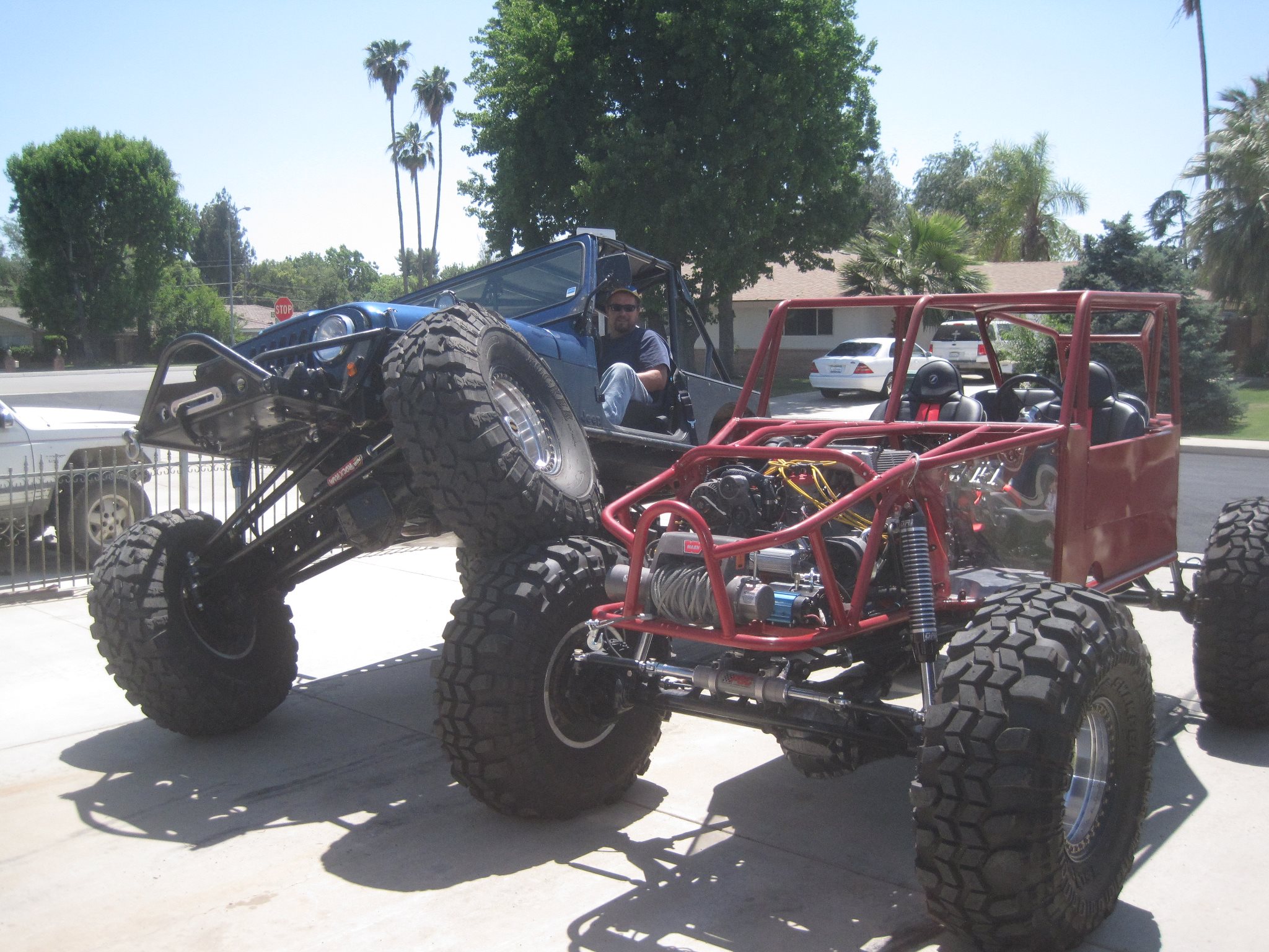

My homie Roberto in his rig he finished. Robert just recently put a 4.0 stroker in his jeep

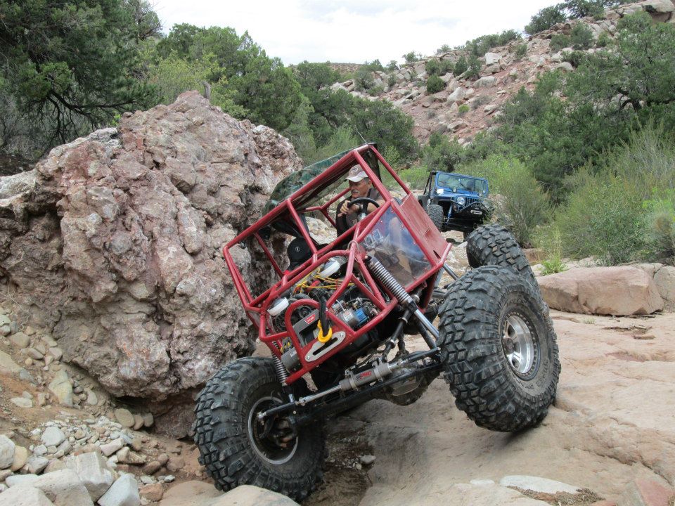

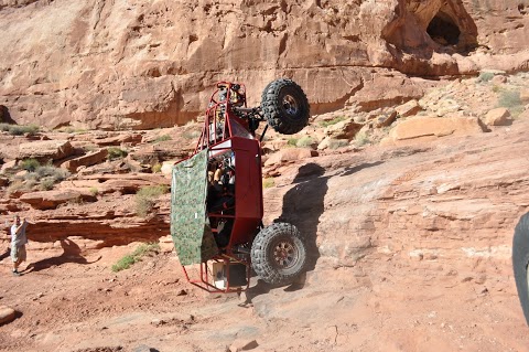

Action shots

HEY WHAT THE HECK!!! My blue buggy went right up this thing
