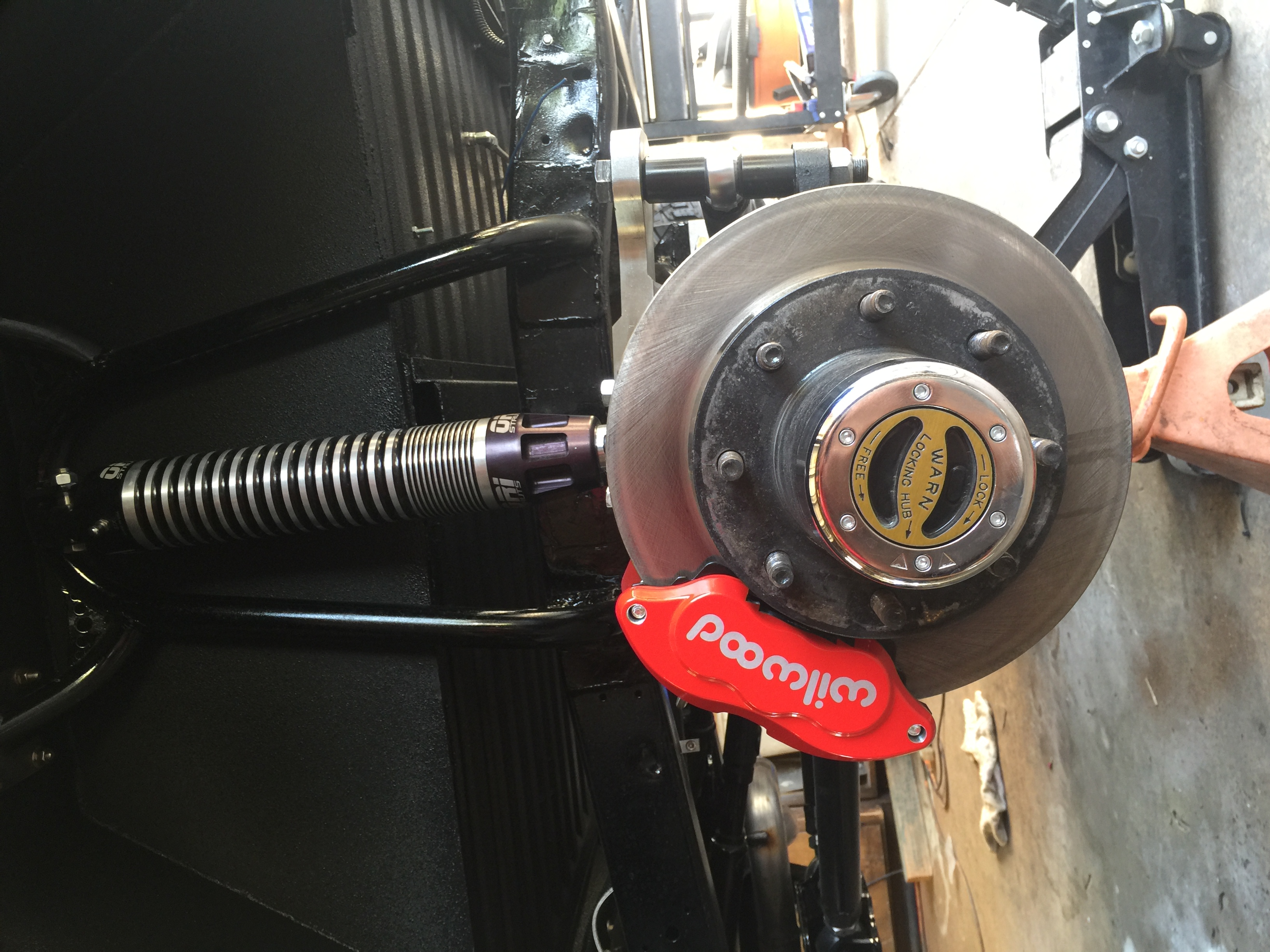

How I got free Wilwood brakes calipers: after struggling for days it was decided that I have to get different calipers or switch to some form of different brakes . They make a 1 1/2 inch bore master cylinder but it positively would not fit under my hood. After speaking to Wilwood I find out they make a twin piston caliper called a D52 which directly replaces the JB6's . Strangely enough they also make a rear version of the typically front JB6's . It's called "special application ", they have little tiny pistons to maintain the front to rear brake bias and eliminates the need for a proportional valve . Discouraged , disappointed and depressed. I go into my office to pay my last payment on a cruise my was paying for through Costco travel . The last payment was 1800 . While on the phone I asked , before I pay will you please check to see if there are any specials that may have come about . After a pause , she came back and said the the cruise line is giving 400 on board credit and they had reduced the price of the cruise by 800. Which happens to be the exact price of the new Wilwood calipers that I previously could not afford. After hanging up I immediately called and ordered the calipers . I walked into my office to pay for a cruise . I walked out having paid for a cruise and buying new brakes . The brakes were definitely free.

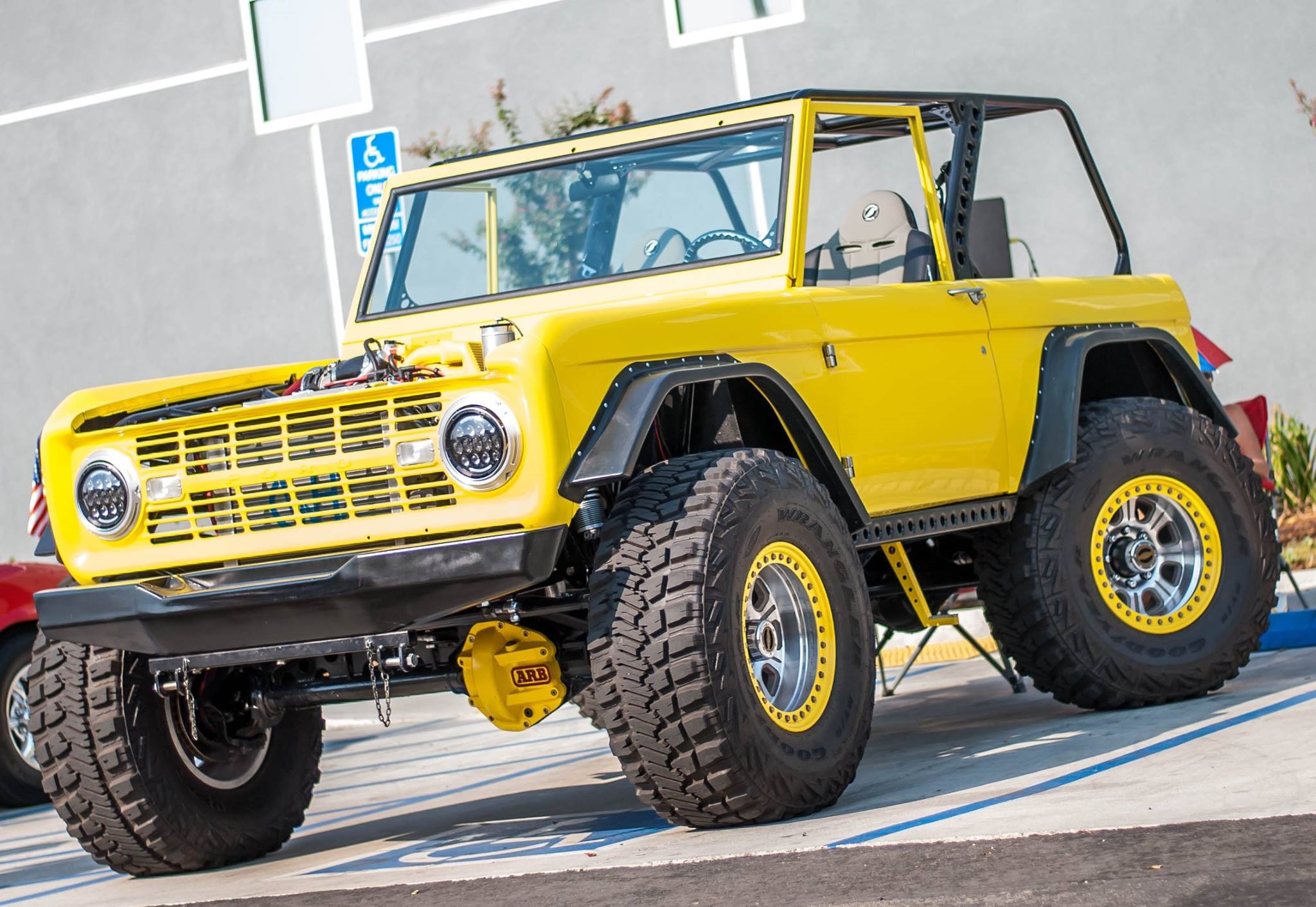

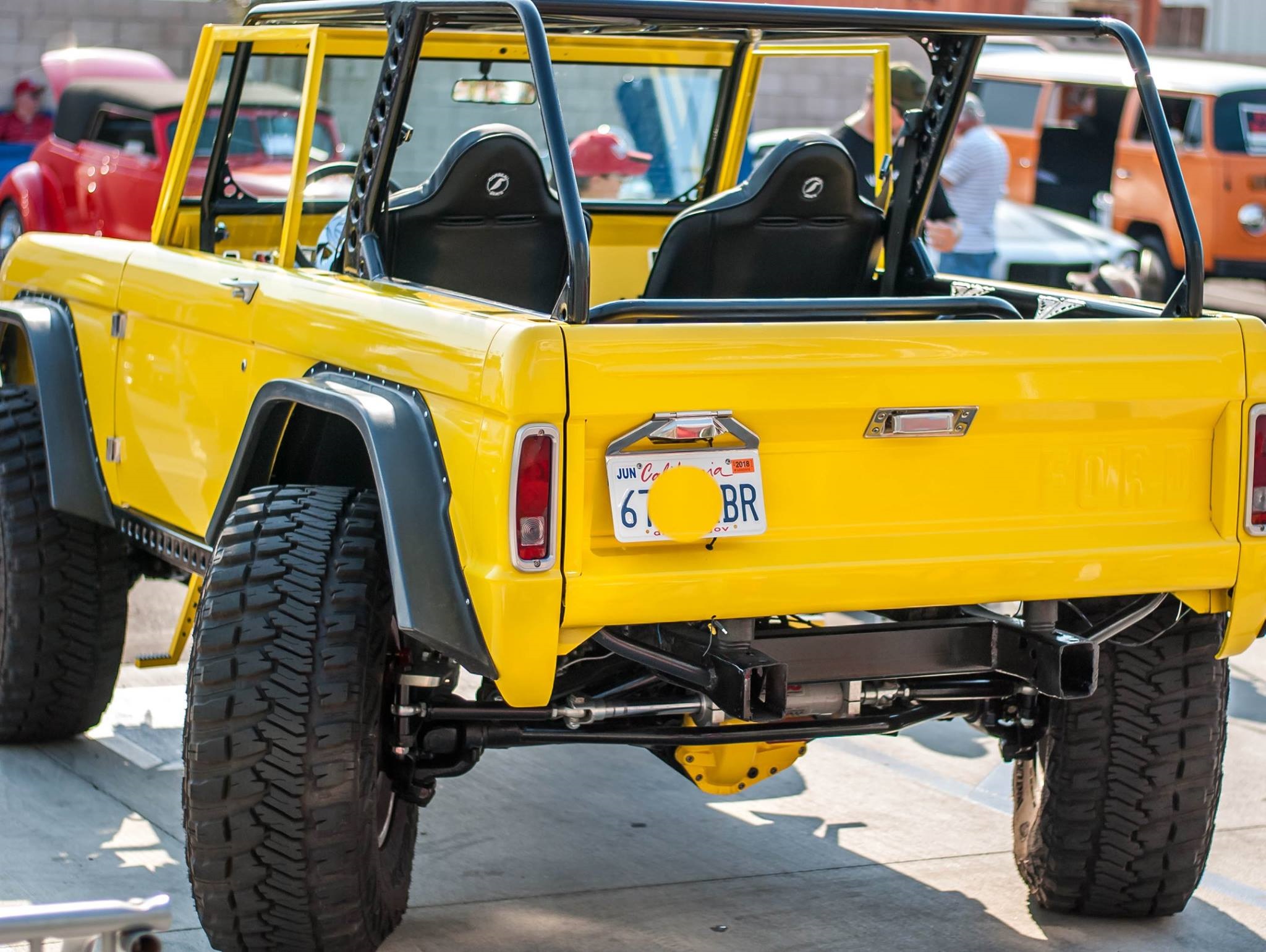

So got the Bronco running and looking ok albeit with tons of little things to fix and repair after rushing to go to the Fathers day car show at Pismo , which by the way has changed to first week in June now.

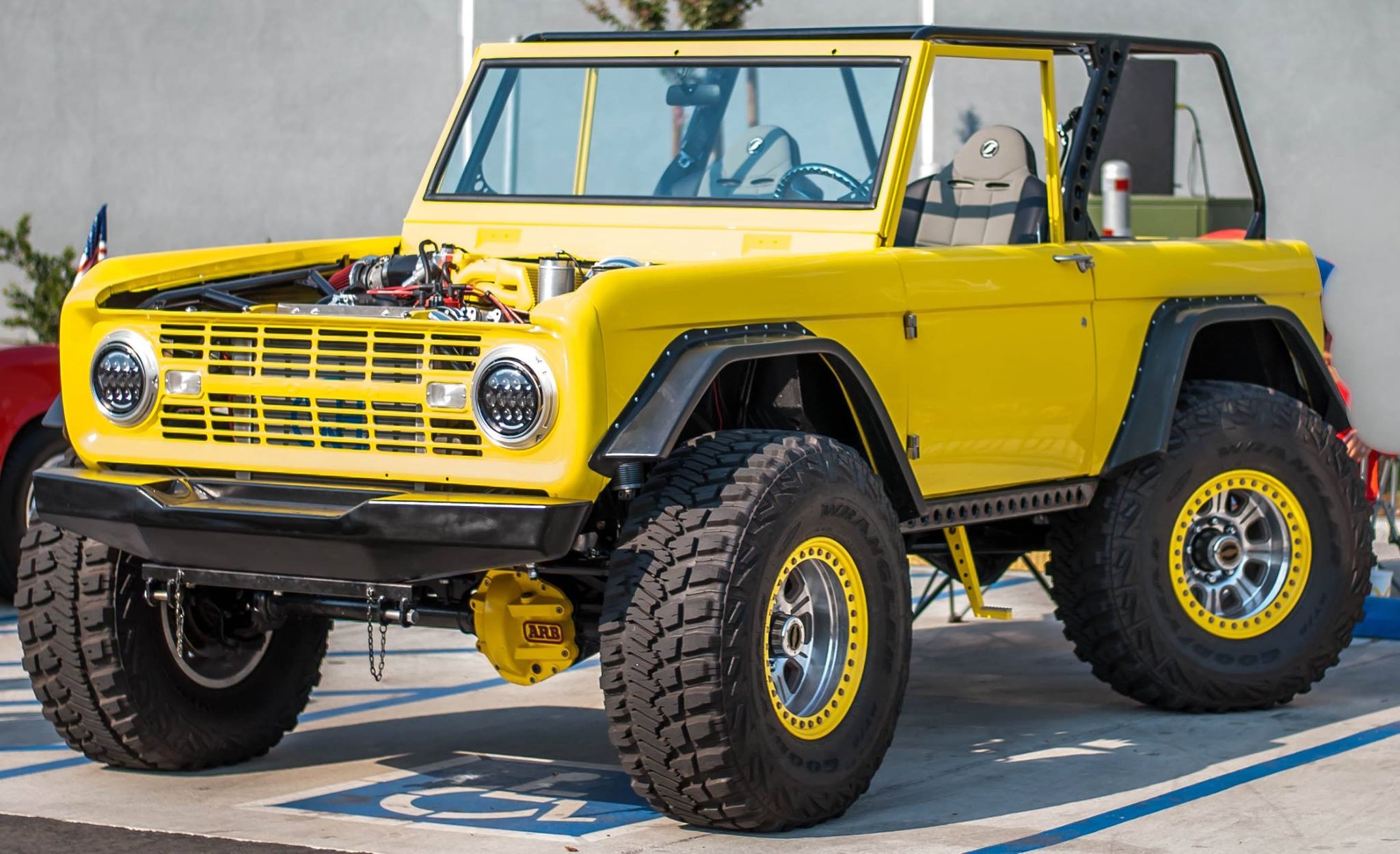

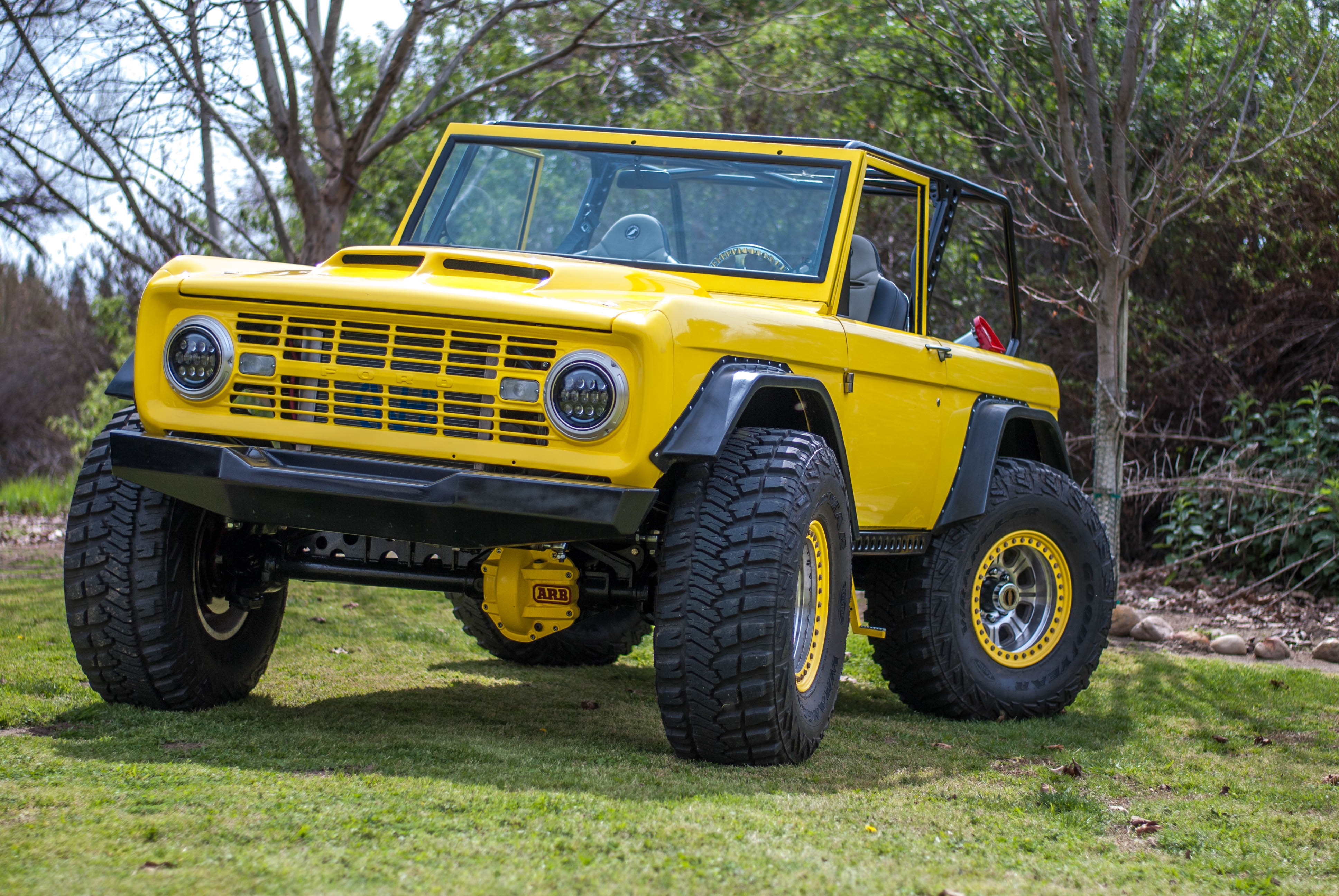

I have a front bumper, it took a couple days of fabrication to get it right. I guess my frame was sort of out of proportion and the such so I had to do some welding and cutting to get it just right . Scratched the shit out of the front grill at the same time ,, I was HOT!!! In the meantime I've been shopping for a Xenon Warn winches. They are black , I need to stick to my black and yellow motif. Cant say I will ever use it , but i'll have it . Now I need to mount the ARB compressor then run the line to the rear ARB air locker and see if John Bahr and I did it right when we put it in . It was used so I had to order then install some new parts for it .

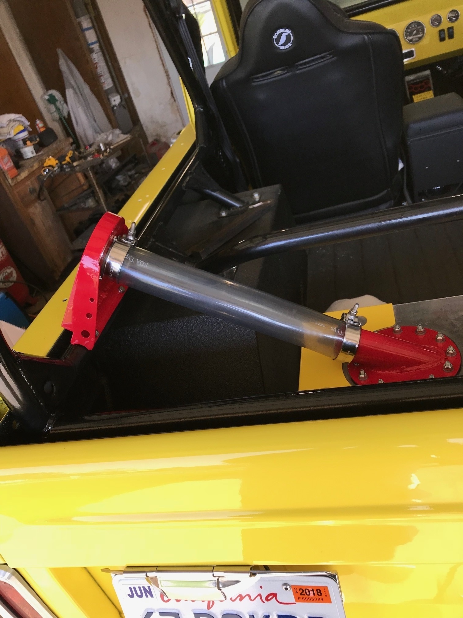

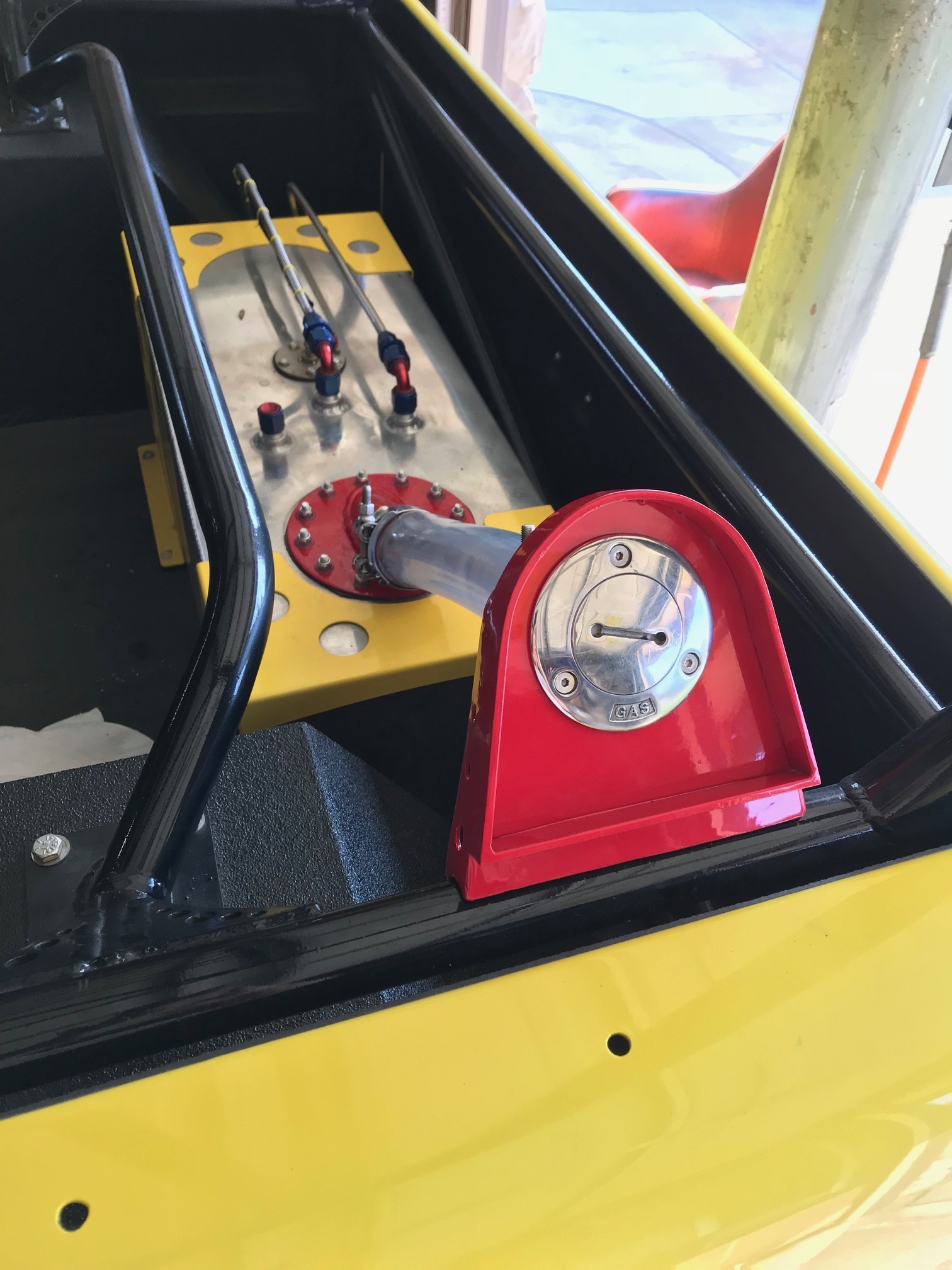

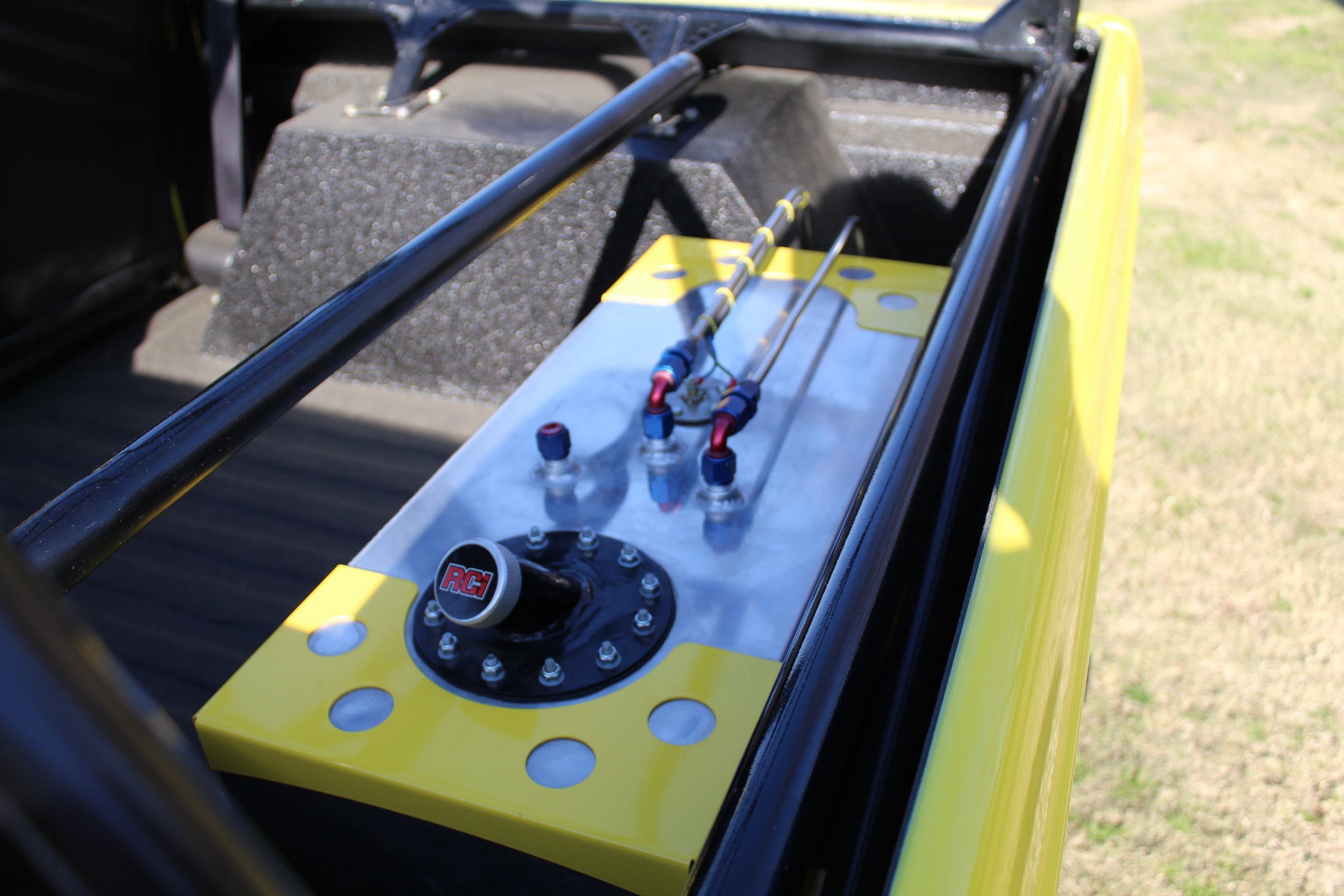

So I didn't like dragging a gas hose inside the bronco . So I cut off the neck at the tank filler neck welded a piece of 2 inch pipe at a slant inline with where I wanted to mount the new filler cap . Then made a bracket to bolt to the role cage I drilled and tapped 2, 5/16 holes in the bar. I had 2 chrome bolts left over from a bolt kit I bought which was supposed to be for a ford intake manifold , (bolt kits seem to never have the right bolts) . They were laser cut with a ford logo on them so that was pretty neat. Got a piece of clear hose from H&S hose . That hose is not rated for gas. I will have to see if it lasts very long. I had an old stainless boat style gas cap I'd saved for years . I polished it a bit and used it.

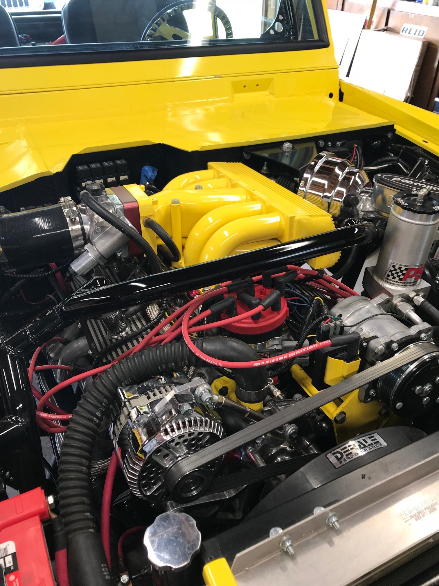

I initially put this bar in the wrong location . Seems easy enough to just set the intake and plenum on and just go around them right? Ya not for me!! I left it off for a year . It would only be a necessary element if I were off roading where connecting the shock hoops would be needed for strength. Finally bent up a piece , went right past the plenum and welded that sucker up. Darren a friend of a friend powder coated it for me in his garage. I went to a charity car show at the Fairgrounds in the rain with the Trailblazers and won a sponsors choice award.

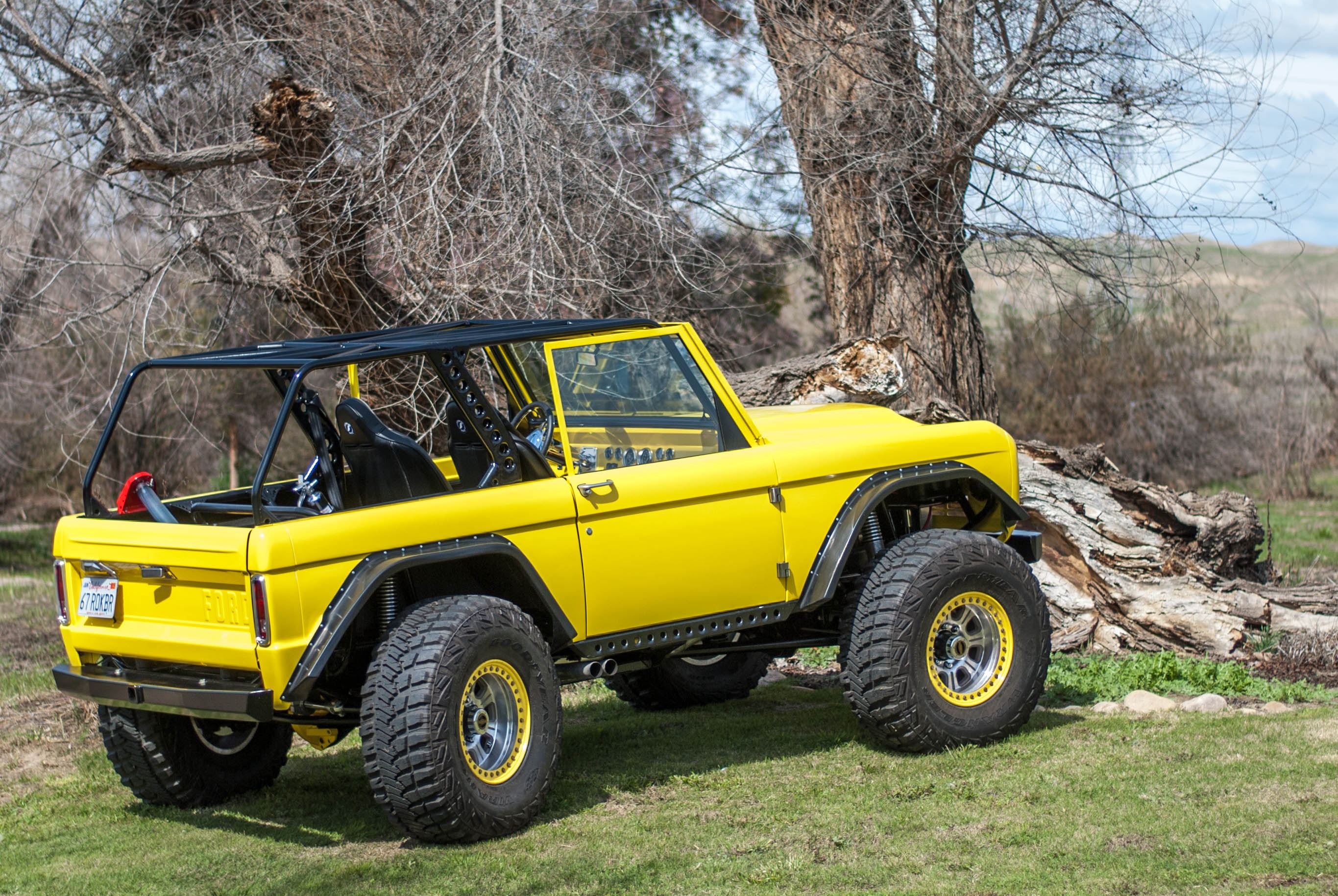

Mean while . I contact Bronco driver magazine about putting ol yeller on the cover. My daughter who is a photographer, shows up from Colorado and I go down to the back yard of some friends of friends to take some pics by the killer Kern river. They complained they were not taken vertically like a magazine cover . Well they never mentioned that so we sent more with one that was vertical and the guys said we are sending it to the graphics dept, which means his brother-in-law at the next desk over.
I called and told the guys at Bronco Driver about my bronco and they wanted to put it on the cover ,, cool
